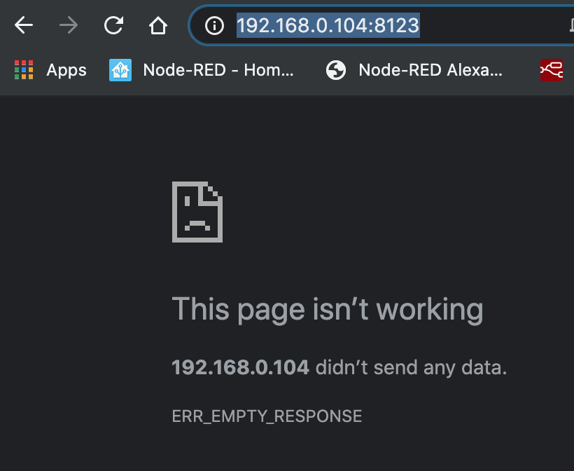

Absolutely no clue what happened. I was just playing around with a node red flow (nothing special, just a light trigger) and suddenly all my devices (phone, tablet, and computer) said “reconnecting” in the Home Assitant apps, and my computer just booted me out to the image below:

but… if I try and connect locally using the IP… i get:
Any ideas or things I could try? I basically got a useless house at the moment
Were you using duckdns.org for external access?
Because they seem to have some issues at the moment.
If you were using SSL, have you then tried with https instead of http in front of your internal IP of Home Assistant?
https://192.168.0.104:8123/ seems to get me to the login page. I guess this is a duckdns issue at the moment for me. Thanks for that.
