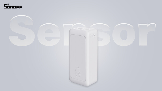

AirGuard TH Pressure (SNZB-02M)

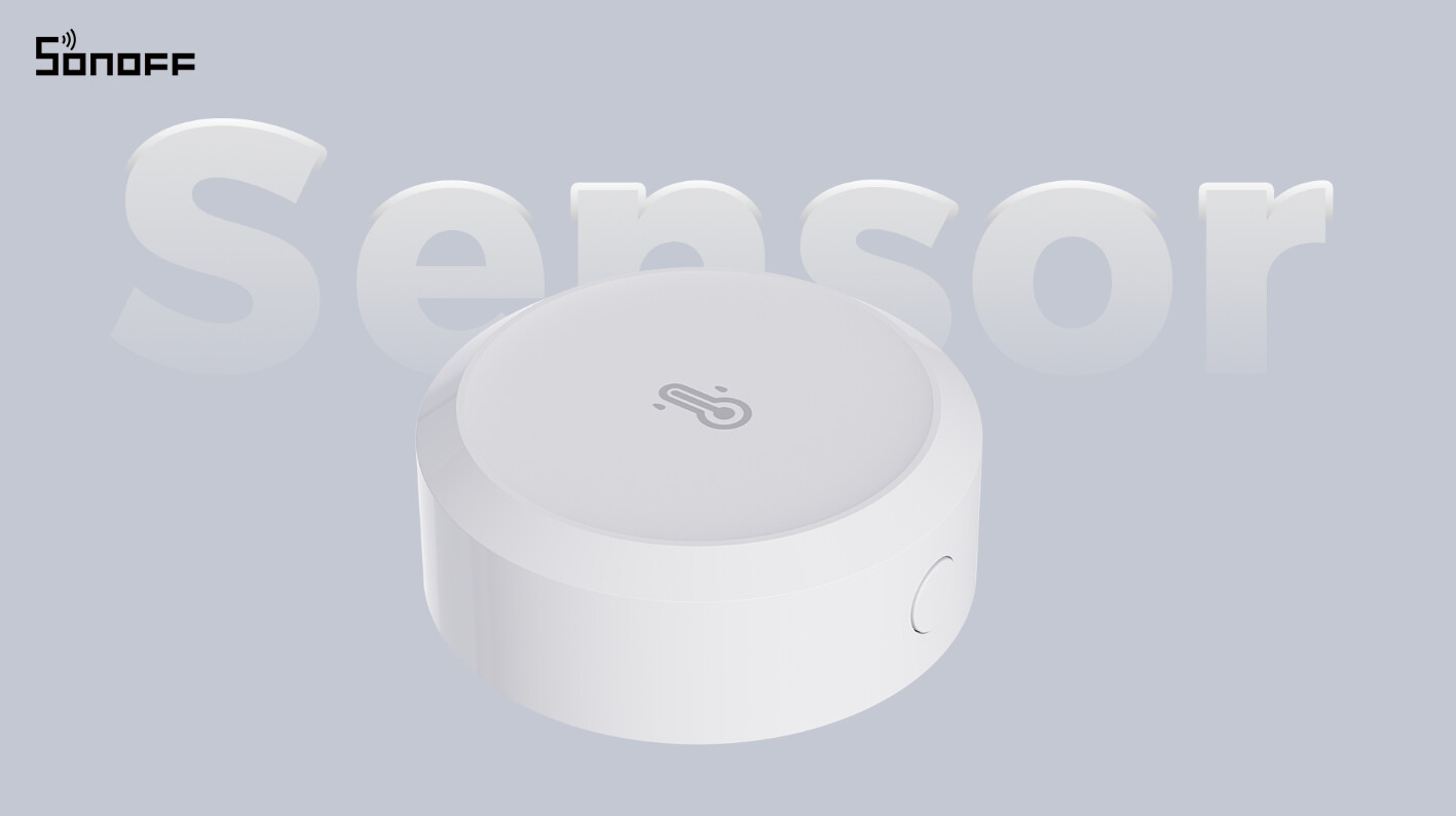

AirGuard TH Lite (SNZB-02B)
