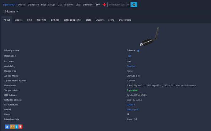

After such procedure my dongle was paired successfully and appeared on the device’s list

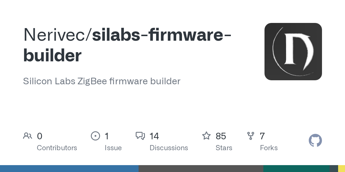

The router software from nerivec auto-connects the router to the network that has pairing enabled.
I have 4 routers with his software, all very stable.
https://github.com/Nerivec/silabs-firmware-builder/releases/download/v2024.6.2-update7/sonoff_zbdonglee_zigbee_router_8.0.2.0_115200_sw_flow.gbl

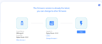

The only way to solve the problem of zigbee router was to use Sonoff flasher:
and install zigbee router firmware 8.0.2
for now it seems solved
thanks for help
