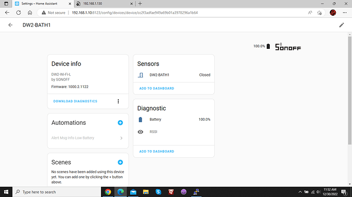

I just added mine 2 days ago. My Firmware is 1000.2.1122. It shows Battery and RSSI. It also shows up as DW2-Wi-Fi-L. I wonder if the devices firmware is the problem?

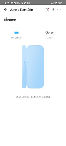

It sucks because the app shows the battery level, so its not a big deal to capture the information, and ald mine has the latest firmware available… :frowning:
I am seeing battery level (100%) not seeing voltage.
