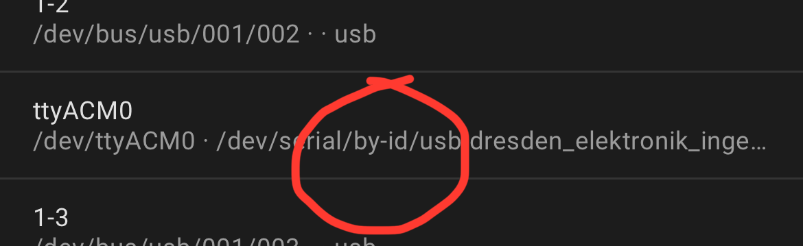

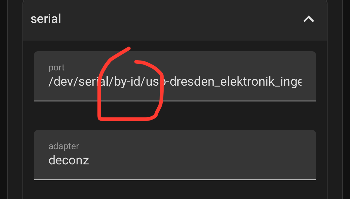

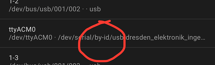

You should add the usb device by id, not by usb port location:
(use device overview to find it)
Especially on virtual machine, the location of a usb device could change after a reboot; however, the ID will always remain the same….
I use zigbee2mqtt, and i use by-id
