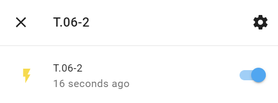

I’ve found a workaround creating a Scene with and Entity but is not feasible for 30+ switches I have and different possible values… is hundreds on Scenes just for that

@ondras12345@anon63427907 Ok, I think this is a good idea on the trigger part but how can I manage the action part? I’m not able to select an entity and the property. I need a “dummy” scene to do it.
It’s very complex
