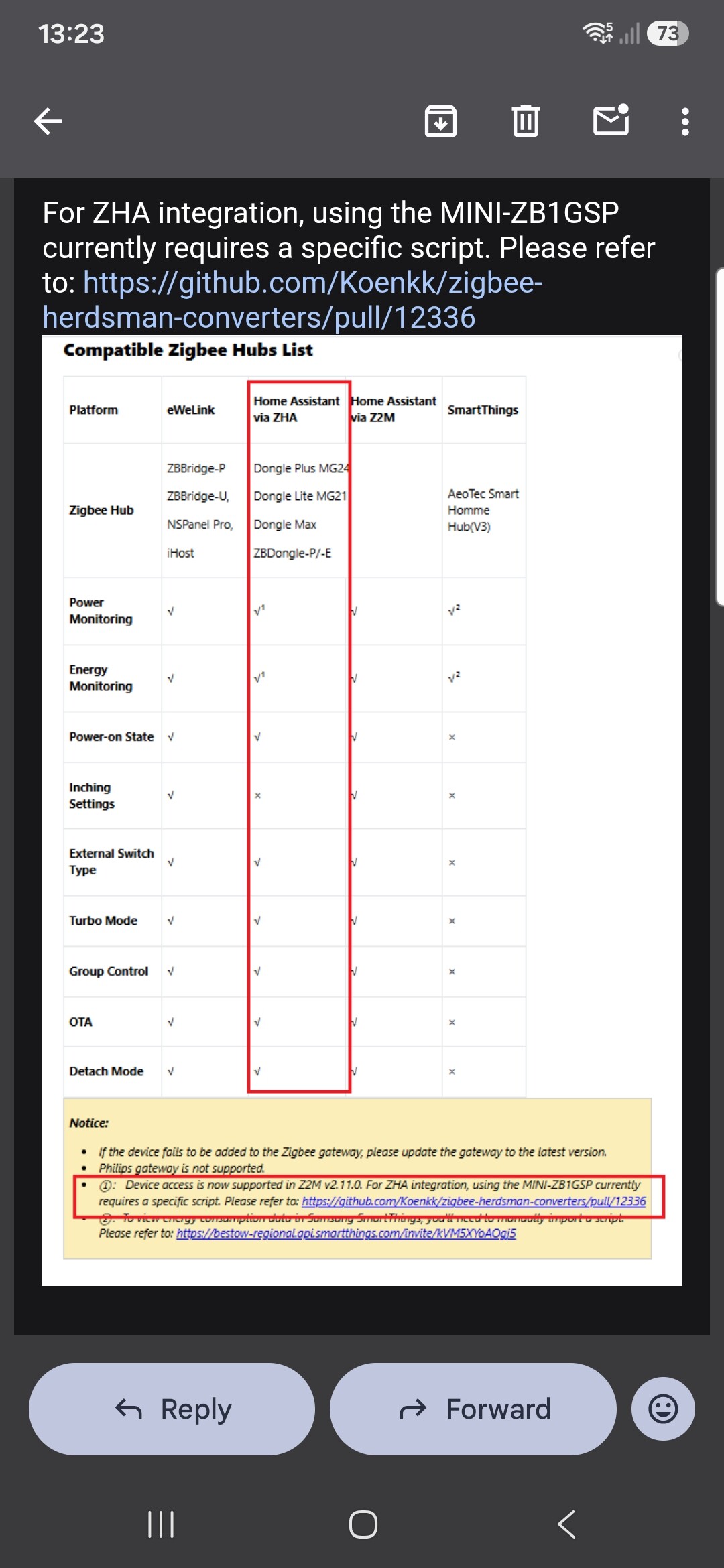

I just got these Zigbee power meters. Sonoff MINI-ZB1GP
I managed to pair one of them to my ZHA integration. I can see it online, but the entities that were supposed to show the power consumption and delivered energy never update. Power stays at -1 W and Summation delivered stays at 0 kWh.
On Sonoff website I found this Notice (of course it wasn't on the product page, it was hidden somewhere in Help section):
" Device access is now supported in Z2M v2.11.0. For ZHA integration, using the MINI-ZB1GSP currently requires a specific script. Please refer to: https://github.com/Koenkk/zigbee-herdsman-converters/pull/12336"
I opened that link, but I couldn't make heads or tails out of that. It is way over my understanding...
Can you help me fix this? I would really hate to switch my entire Zigbee network over to MQTT, I have over 100 devices. It would be a pain...
Thanks!

The "script" they linked to is for Z2M & won't work as-is with ZHA. Basically, that link is wrong & they need to fix the link for the ZHA quirk. If they didn't create one, then you're basically out of luck until someone does.

I created a ticket with Sonoff support and asked them to clarify this. I hope they can fix the link or provide me with the solution for ZHA.
I wish they wouldn't advertise the product as working with ZHA, when it is clearly not the case.

Spoiler alert, I had a look at the commits from that github user. The only non-Z2M PRs were the ones raised in HA Core (not even in zha-handlers) for their coordinators. Didn't manage to find a single PR for their other devices.
You might get lucky & maybe another user from the company added PRs for the devices, but I wouldn't bet on it. Might be a good time for you to buy a second coordinator & start migrating stuff slowly over to Z2M. Your situation is exactly how I got started with it.

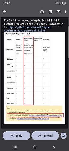

Yeah... This is the reply I got... :man_facepalming:
This support tech has no idea what I am talking about...
i also contacted them and got this reply:
So… good news / bad news situation here :slight_smile:
Good news: I got an update from Sonoff. They sent me script that it is for ZHA. So they say, at least.
