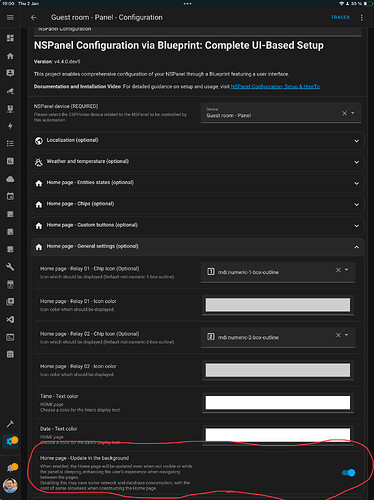

If you have assigned an entity with a high-rate of updates, that will trigger the automation on each change, so your automation can also be high-rate of executions.
Most of the pages are updated (triggering the automation) only when visible, but the home page can be update while not visible depending on your setting under the Home page general settings:

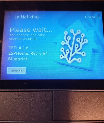

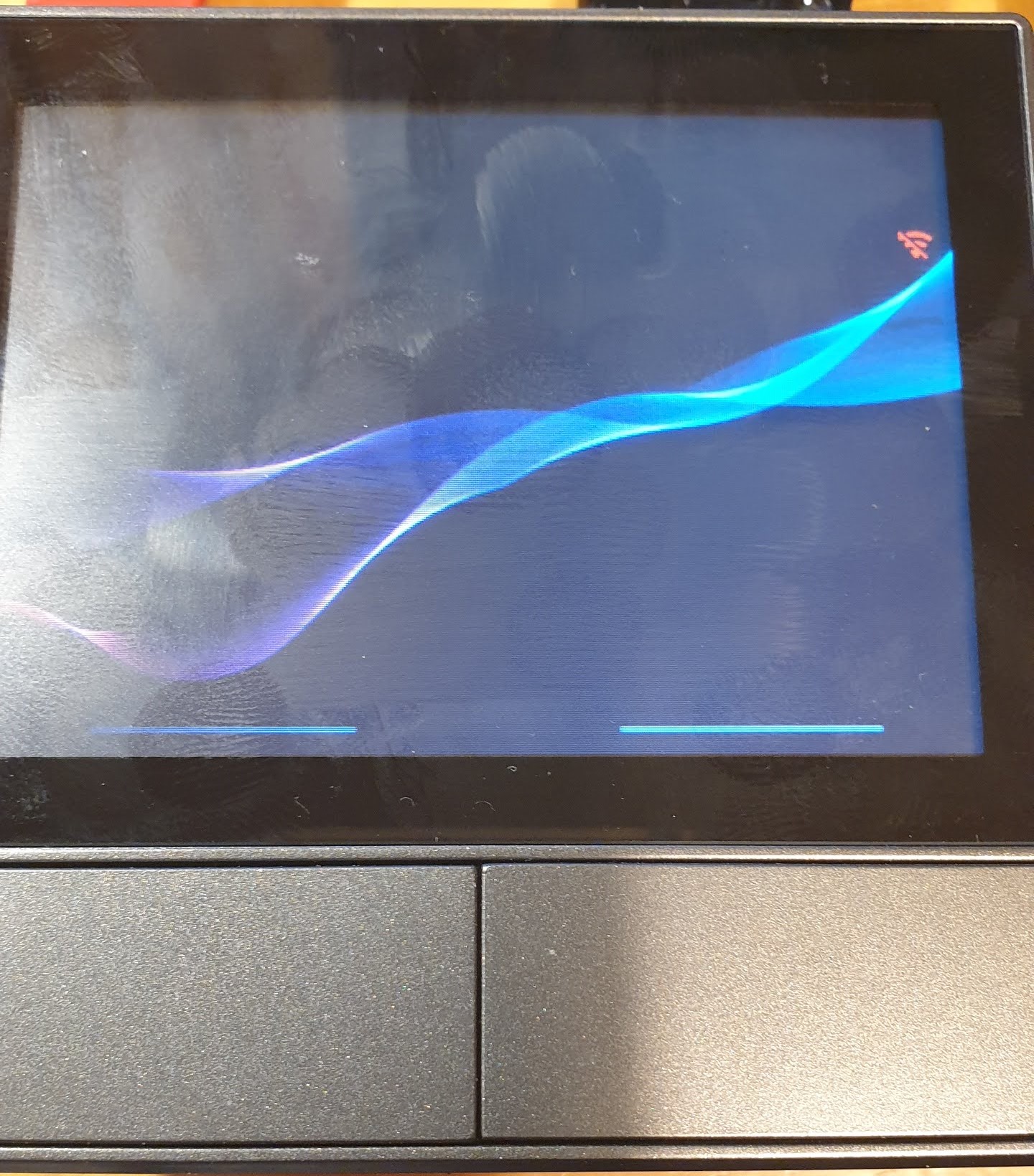

Now nothing works. I’ve got some basic screen with incorrect time on it. And I don’t think it’s connecting to the WiFi. And the house is getting cold!
Is there someone out there that can tell me quickly what I need to do to get it all working again as I’ve totally forgotten how I did it in the first place.
I’m guessing I have to physically connect it to the computer USB and do some downloading, but I don’t really know more than that.
Update:- I’ve got the latest ESPHome Compiler (2024.12.2) and the latest Blueprint (v4.3.12). I tried to update Panhans Advanced Heating Control from 3.7.1 but the auto method couldn’t find the page! I’ve checked my version of the NSPanel Template in my Automations and it Validates ok. I’ve tried to install it both manually using the ESPHome Web, and directly. I have a USB to serial adapter and followed Mark Watss’ instructions. Both installation seemed to work and complete but when I power up the device I get the blue bootup screen
but it then goes into some basic Sonoff(?) flash screen

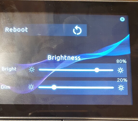

with no info on it and I cannot find the device on WiFi (I have a fixed IP address in my short ESPHome file (which I have not changed. I can also get a settings screen by long pressing the little red WiFi symbol

I was expecting it to boot up and connect so that I could then update the TFT file through HA but I’m not getting that far.

All solved now. Turned out my router was not allowing the WiFi connection until I rebooted it.
The NSPanel got connected and starting displaying some things ok (Button pages), but the main screen was missing loads.

Figured out that to keep screen always on I need to set Timeout Sleep to 0. But I still use the Timeout Dimming to reduce the brightness unless I press the screen. Perfect. Might save a watt or two in a week.

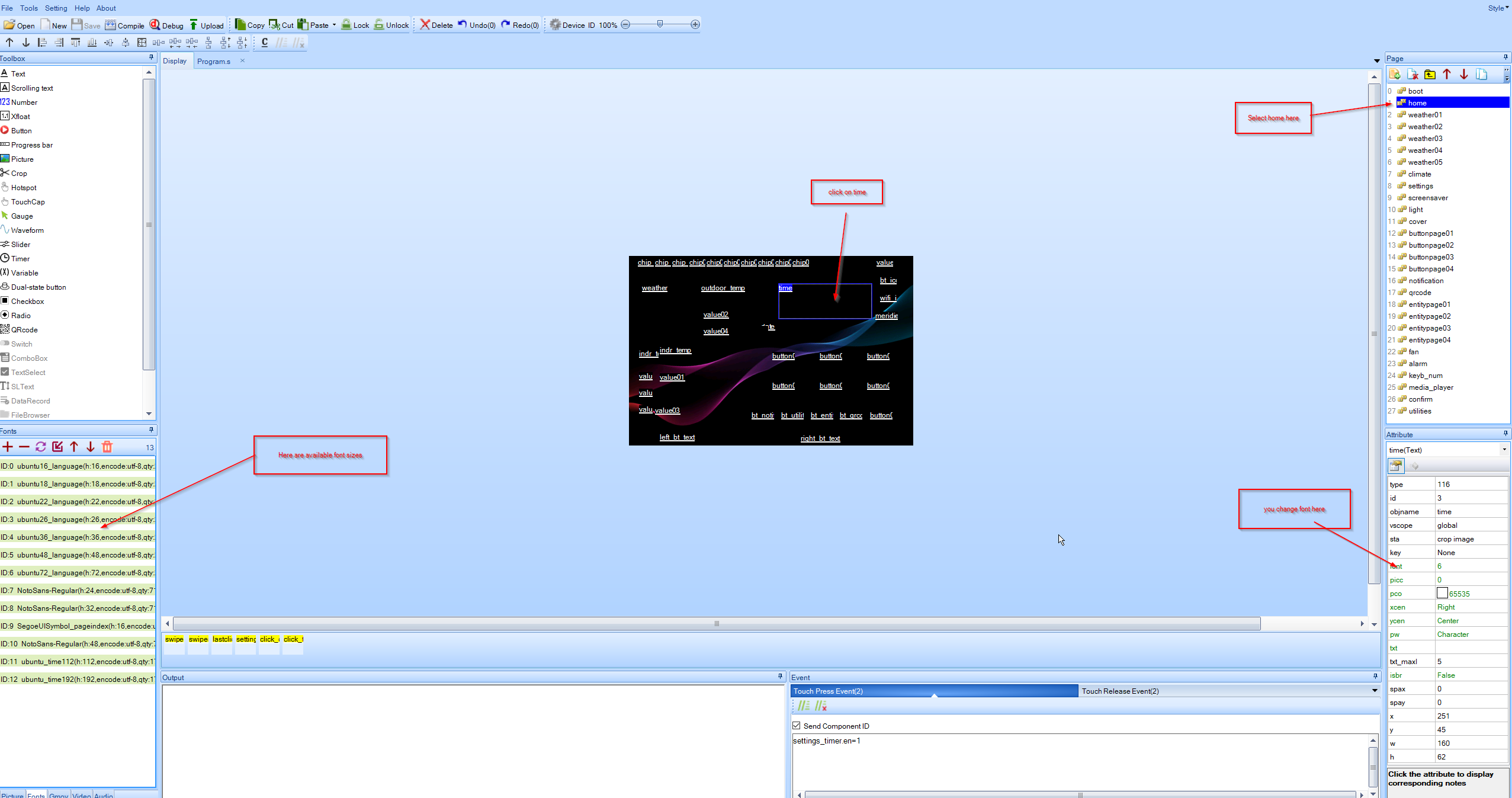

Yeah, i wanted the same - from UI it’s only possible up to certain size. Bigger font is possible, but you must edit panel’s automation directly in yaml mode, find correct variable and enter bigger font number there, it works.
Any clue what values is that?
Ouch… i was a bit ahead of myself… i changed font size of something else inside automation, not clock. But for time i think that only way is edit nextion’s file with nextion editor, since time size is defined there. Of course, this requires compiling and uploading this custom file on NSPanel. Depending on new size relocation of clock position would be needed also (you only drag it to new position).
