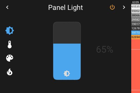

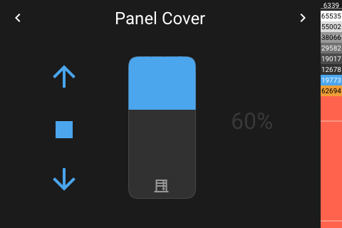

A new release:
panel_clock_background
panel_clocktwo_background
panel_cover
panel_light

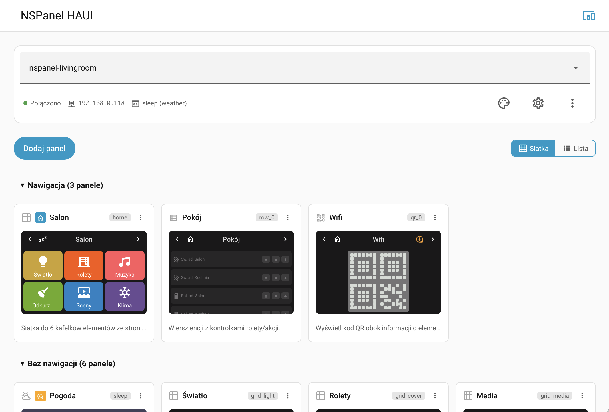

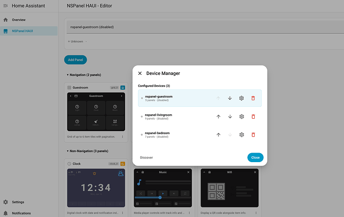

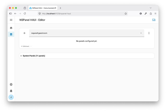

A quick update, NSPanel HAUI has now a editor, also does not relay on MQTT and AppDaemon anymore. A custom integration provides now all functionality. Current code is located in dev branch, more to come ...
Integration supports auto discovery
Integration provides a device editor
Multiple panels
Simple device manager
Some impressions

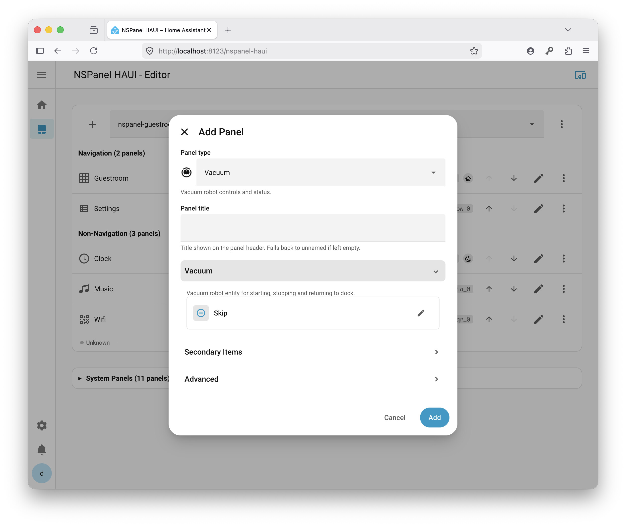

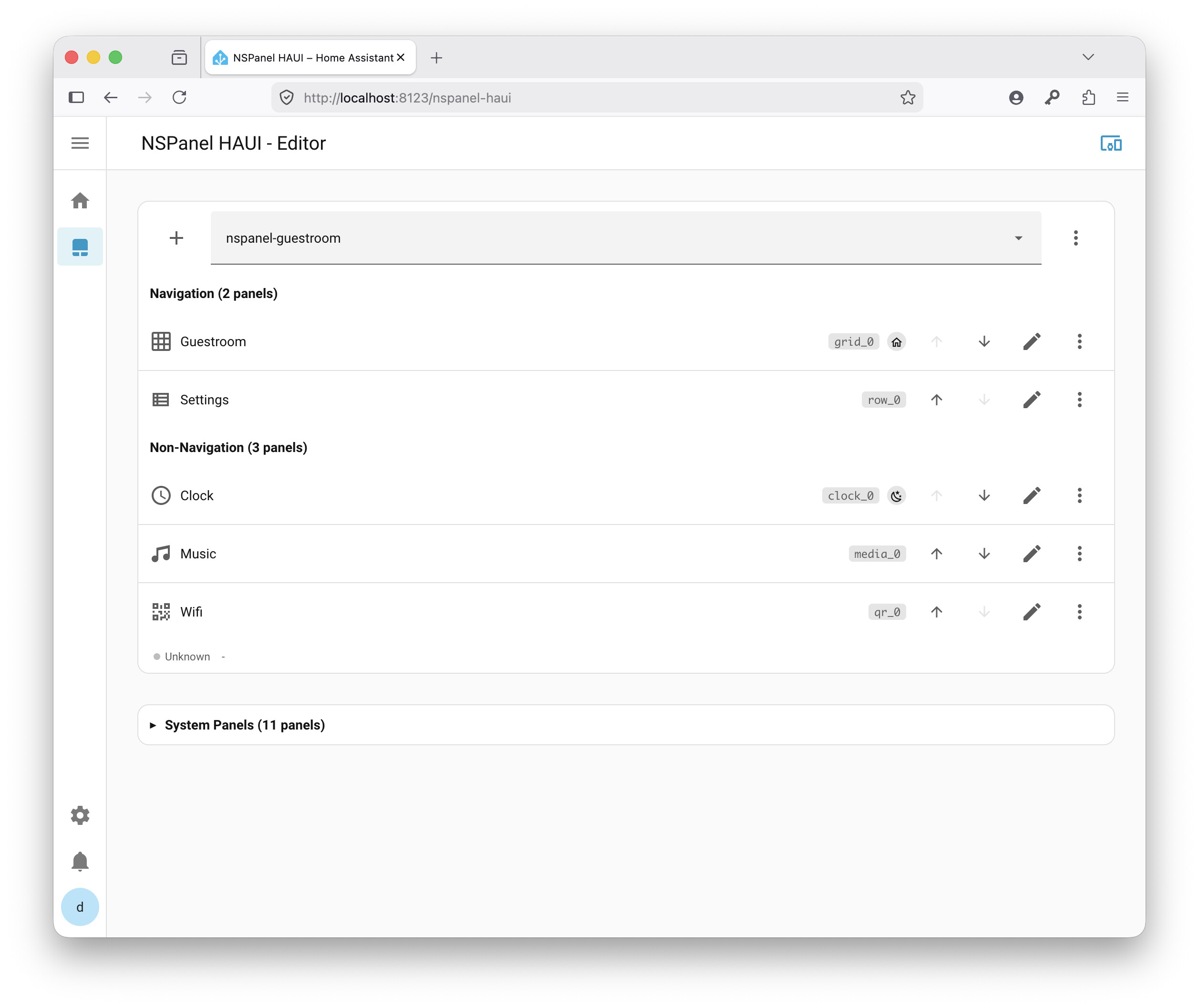

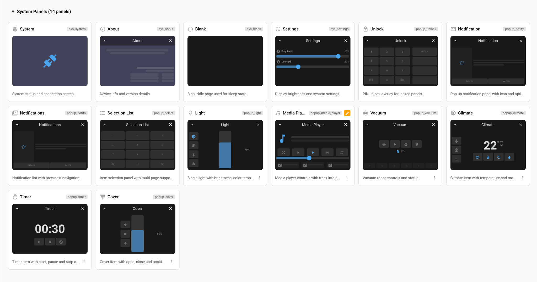

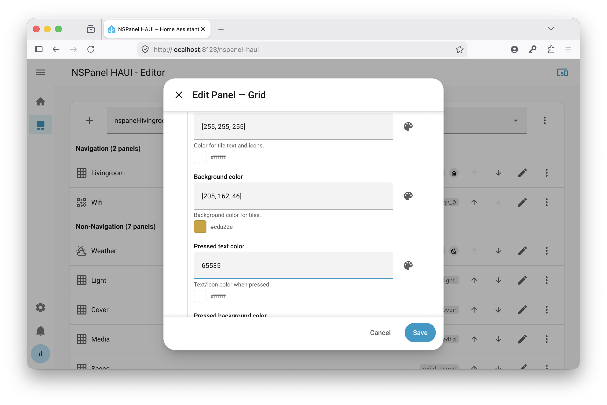

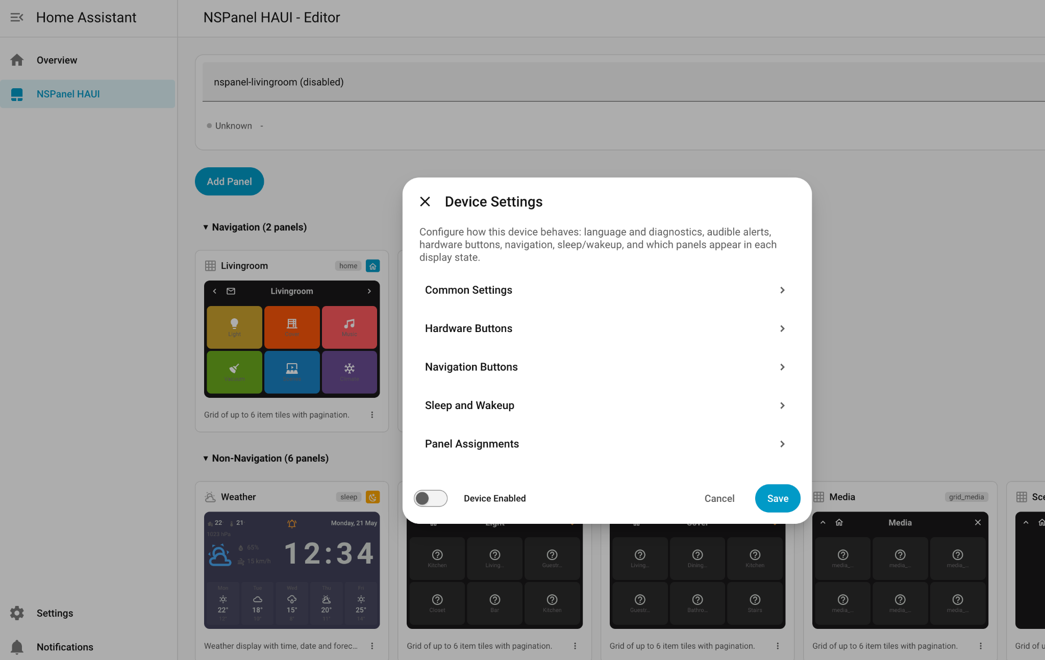

A new version was released: Release 0.3.0 - Welcome back · happydasch/nspanel_haui · GitHub
this changes how nspanel haui works:
  • no AppDaemon or MQTT needed, only the custom integration
  • Configuration is available in frontend, no yaml config file anymore
  • Yaml import / export is available

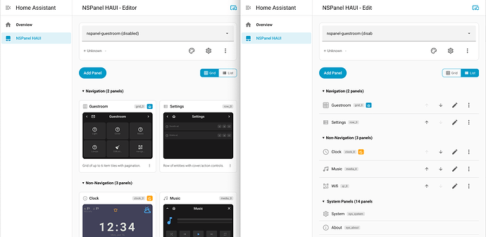

More screenshots from the new integration:
