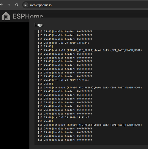

Serial log shows endless loop:
invalid header: 0xffffffff
ets Jul 29 2019 12:21:46
rst:0x10 (RTCWDT_RTC_RESET), boot:0x13 (SPI_FAST_FLASH_BOOT)
Loop repeats indefinitely.

I’m attaching the serial log screenshot for reference.

The boot log always shows a continuous loop like this, regardless of firmware:
Sometimes the header value changes (e.g. 0x79616c70, 0x50434d7c), but the behavior is identical: watchdog reset loop, no WiFi, no AP, no LEDs, no application logs.
