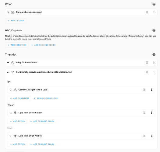

I find myself in the same situation as you, I’m trying to use the ‘brightness’ and ‘presence’ of the SNZB-06P in an a light automation, it would be a really neat automation.
The documentatioin I reviewed
states that the brightness is only updated when presence is detected so using it in an automation will not be straightforward
