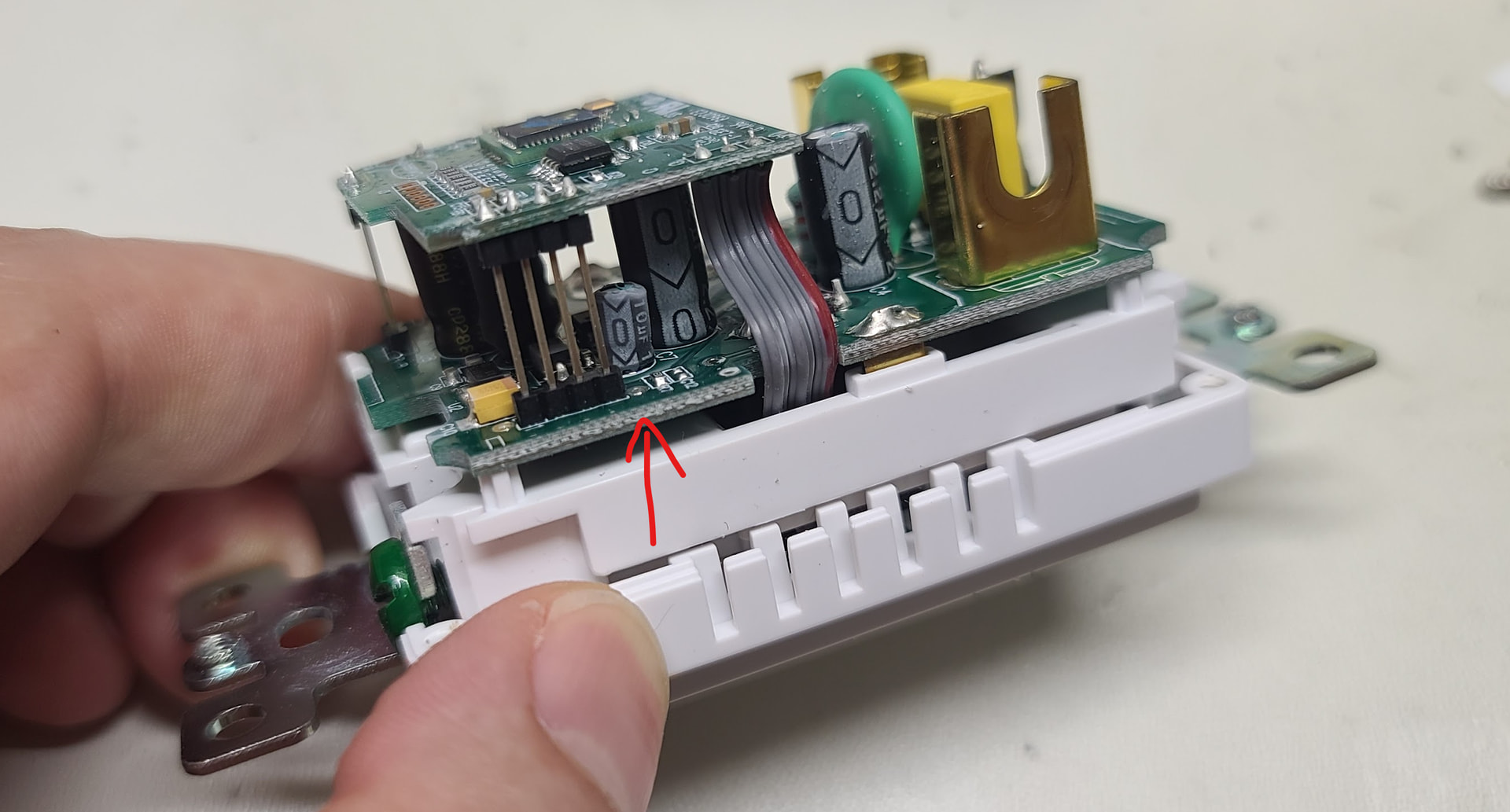

@chairstacker - I usually take pictures when I do mods or repairs as a reminder but this time I did not. I recall that the faulty part was obvious so it was either bulging (rounded top, puffy, split on top where sometimes there is a plus groove to help it split open if needed) or leaking (often brownish stuff out of the top - split top - or bottom - where relief vent typically is.
I searched the web for a clear picture but the best I found was this:
Top left - green cap (small chance I am remembering incorrectly, but I do recall it was easy to fix so I doubt it was any on the other side).
I believe the cap is a 470uF 10V. Stick to 470uF but voltage can be higher, but keep in mind that space is limited and a higher voltage cap might be larger.
Since I could not remove PCB from the base without major work (was also concerned about melting plastic case if I applied needed heat to the large pins soldered to the PCB), I pulled on the bad cap to expose as much of its legs as possible, and I might have cut it towards the bottom of its body - again to leave some workable leg. I then soldered a new cap - legs to legs (mind polarity). Not ideal, but this device doesn't have to deal with vibrations and/or heat so I think it is safe. If you have appropriate electronics adhesive, you could secure things with that... I didn't so I left it as is.
On another note, if one cap is bad, there is a chance the others are too... or could be soon. Unfortunately, given the PCB is so hard to get out, I only replaced the one. Typically I'd just replace them all.

The cap itself came off with the legs still nicely attached to the PCB, so now I just need to give it a try :slight_smile:
