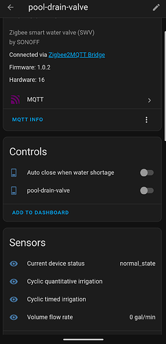

Hi, i have recently bought a SONOFF Smart Water Valve and i have connected it throught Zigbee2MQTT to my server. Some entities are discovered like the switch that turns it on and off and the flow rate senor which outputs data in m^3/h. I would like to create an entity which tracks the total water consumed since the last on state of the valve and an automation to turn it off after an X amount of liters have been through. I tried using an utility meter helper, however the results where in m^3/h and not m^3 or liters. Any ideas?

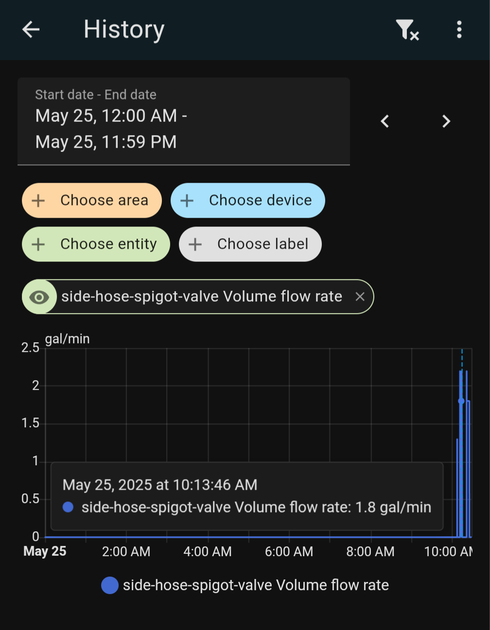

I’m just using the included entity sensor for flow rate:
@Gurulee Thanks but correct me if I’m wrong, this is only showing the flow rate and does not show the actual usage?
Flow rate equates to actual usage. If there’s no flow detected then there’s no usage.
