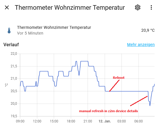

My eight snzb-02d devices are (were) running quite stable for several days… until the weekly automatic reboot of my home assistant system last night. Two of the devices didn’t report after the reboot (showing constant values for temperature and humidity and a ā€œlast seenā€ value before the reboot).
What is interesting: I could heal the problem for both devices by a manual ā€œrefreshā€ of temperature and humidity in the z2m device details.
grafik
grafik
Since that manual refresh both devices are reporting regularly ever few minutes again.
So this may be a problem in z2m? Or at least a possibility to workaround a device problem by an automatic refresh triggered in z2m?

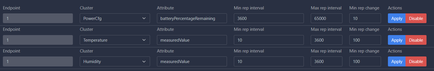

Hmm - have just got into Zigbee to MQTT using a Sonoff Zigbee 3.0 Dongle-P as a co-ordinator (as reports I read seemed to say it had slightly better compatibility than the E one). I paired a few of these Sonoff SNZB-02Ds along with a Thirdreality presence sensor and a Moes door sensor. The latter two devices work flawlessly, despite being further away and having worse signal strength!
However the 02Ds have been pretty poor - initially reporting regularly but then a day later I noticed most of them weren’t updating or if doing so then only very intermittently.
Looking at the reporting settings they should be doing it every 5 min (if no significant change):
They sometimes do for a bit but then just stop for hours at a time:
The different sensors seem to have stopped at different times and other devices are OK so I’m guessing it’s more of a firmware issue on the 02Ds themselves. Is it worth persevering with them or have folks found the simple Aqara sensors more reliable? (I’m still in the easy return window with Amazon for the 02Ds)
