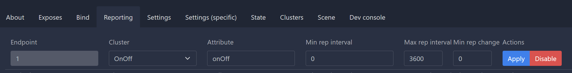

Thank you for the clarification! Yes i meant that “expected behavior” was indeed what I had expected, i.e. sending status even though the change happened by pushing the device button.
I actually reinterviewed the device and now the status is correctly reported, so problem solved! I didn’t know about the page you suggested looking, so thank you for the tip!

Interesting observation - I think it might be z2m not syncing the state properly. If i click the manual button, then sync, the state updates. Otherwise it goes to the de-synced state. After re-configuring the device, it works like normal - strange.
