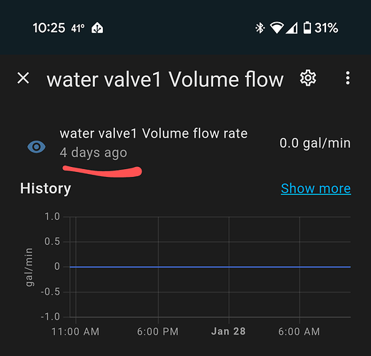

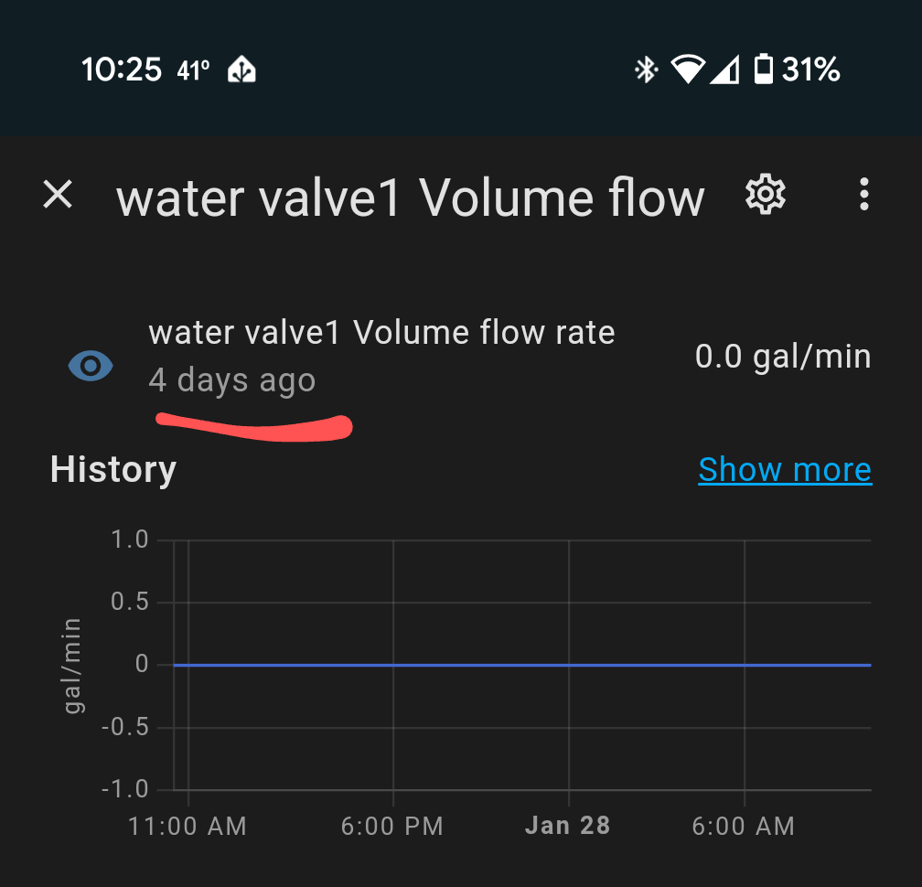

SONOFF sent me a replacement SMV and the same issue persists, no data from volume flow rate entity.
I tried throttling back the output spigot in front of the SMV and left it on with water flowing for 20min, but entity does not update and no data.
Also noticing the volume flow rate entity is not updating since 4hrs ago even if I ping it toggle it on/off:

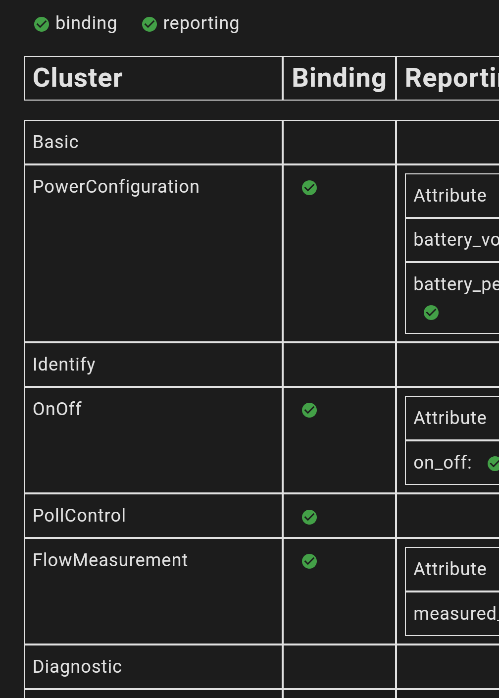

Reconfiguring the device in Zigbee and toggling it on/off succeeds, but still does not update the flow rate entity.
Bindings and reporting show good:
I am testing again from a different house hose spigot and same results with no volume flow rate readings. I even tried dialing back the house manual valve to see if it was too much water pressure, still no luck. I filled my hot tub for 30 minutes and it didn’t read any of it
Any ideas?

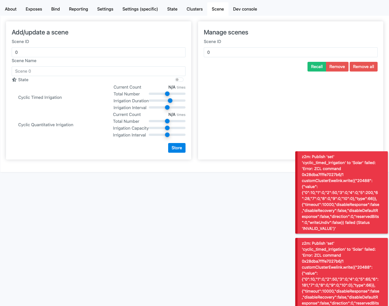

Same issue here, anyone found any solution for this ? Giex is more capable but it is so unreliable but this one seems more stable but a lot of features are missing from it, it does have the flow meter, i see once it is on but i don’t see how many litters i used for each irigation and they don’t add like a index anywhere so that is the purpose of that sensor if we cannot use it ?

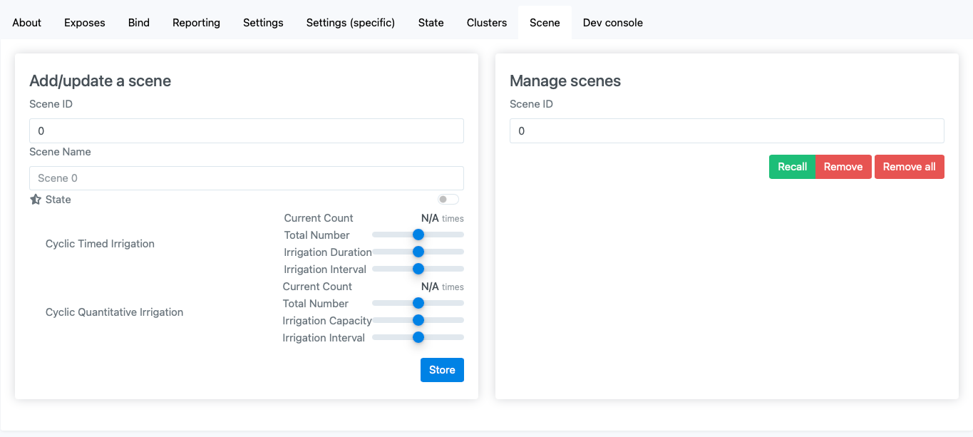

i see the scene part in z2mqtt and unfortunately all those sliders but no values so no idea what you set there and once you start to slide one i get a lot of red error warnings like
so how is this supposed to work ? i assume that it is an unfinished part of the code here or something .

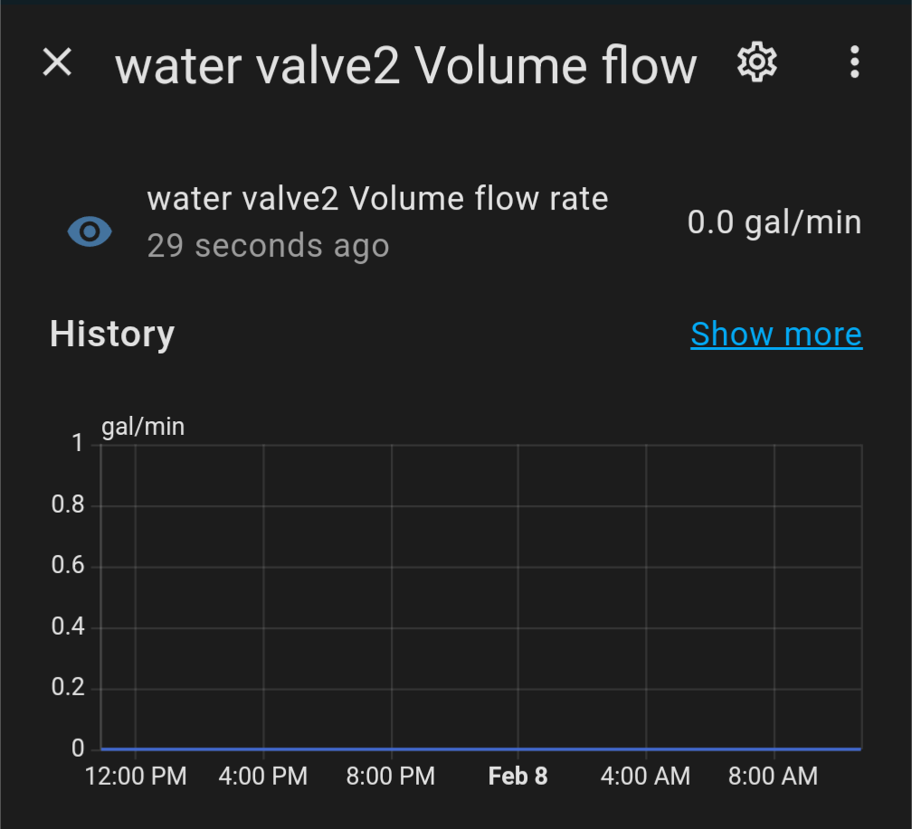

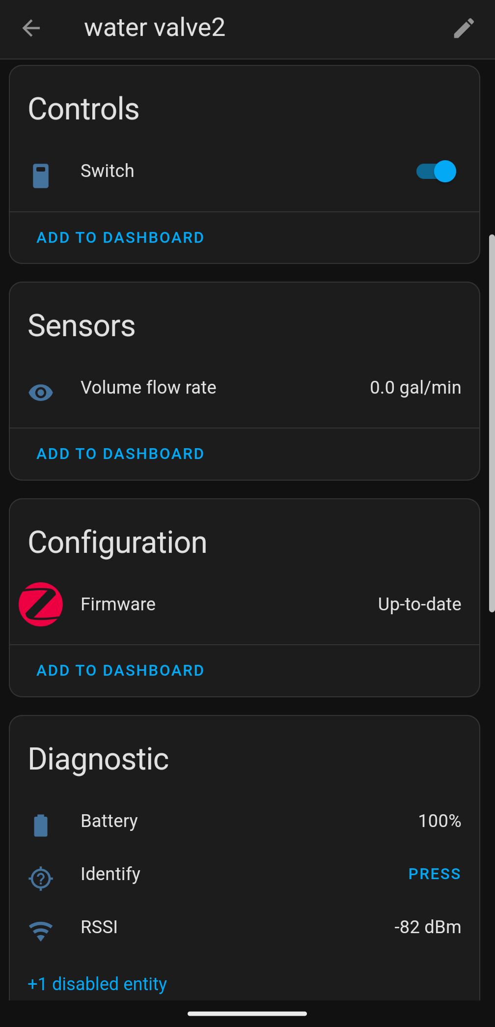

So after back and forth with Sonoff support, they recommended I change the device from zha Network to z2m network. I want to run both these networks in parallel, so I bought the Sonoff ZBDongle-E.
well i have same thing, i put the dongle, and my devices are all on z2m and today i got the surprise that even do i set the unit to turn off, and HA confirmed that the unit turned off apparently, after arriving there , after 3 hours i discovered that the water was still on and ended up flooding my crops so , unfortunately this is just waste of money and not reliable. i cannot risk. to have such a mess in my garden and waste water and all that for things that supposed to work but don’t work , sadly i will have to give up to smart things and go back to reliable standalone programmers and let them do the job.
RESOLVED!
Everything is working now for me and issues resolved. I converted Sonoff smv valves from zha to z2m and they’re working great. I see water flow rate and everything now.
I installed the second zigbee dongle, one is for zha Network and the other is for my z2m network. Some zigbee devices just work better and offer more features on z2m than zha.

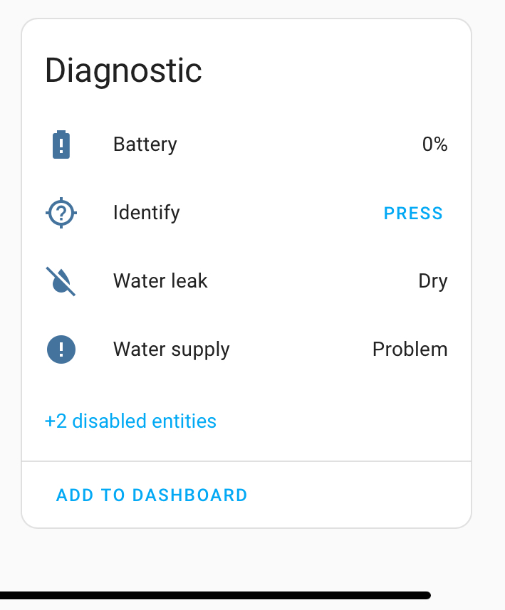

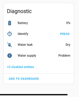

Both Water leakand Water supply are binary_sensors.
Water leak becomes true under what circumstances?
Water supply is either Ok or Problem. Once again, what causes a “problem”? The log just says a problem is detected but not indicating what the problem is.
Also, why is my battery always reading 0%? I just verified I have fresh batteries in there.

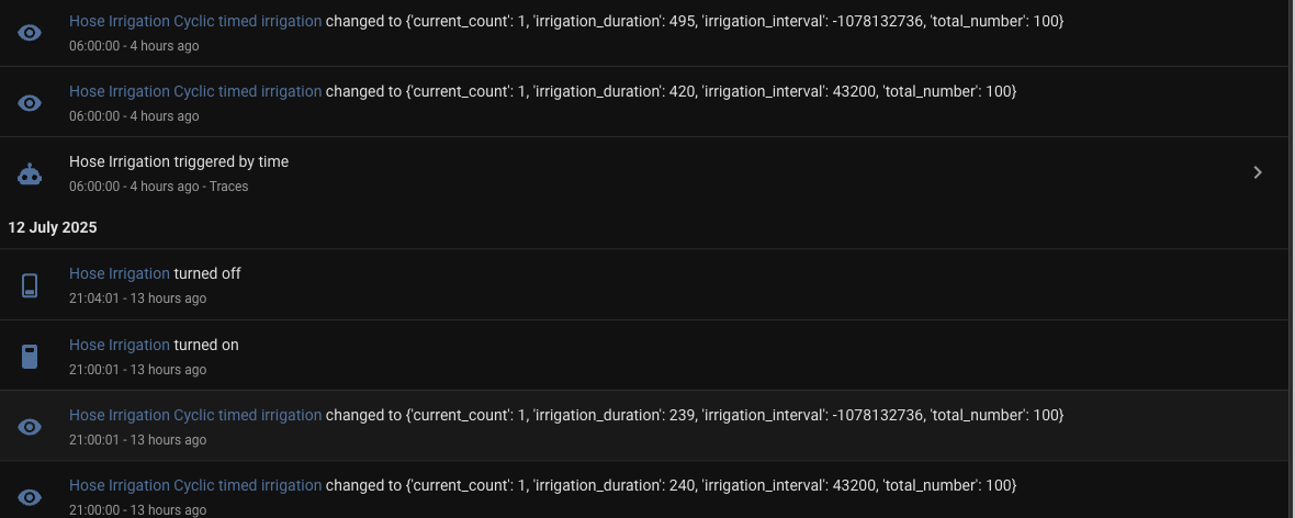

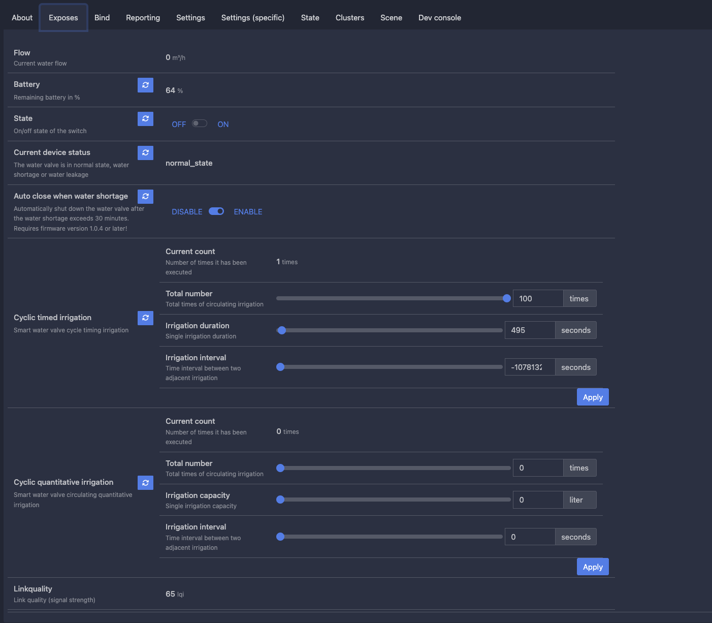

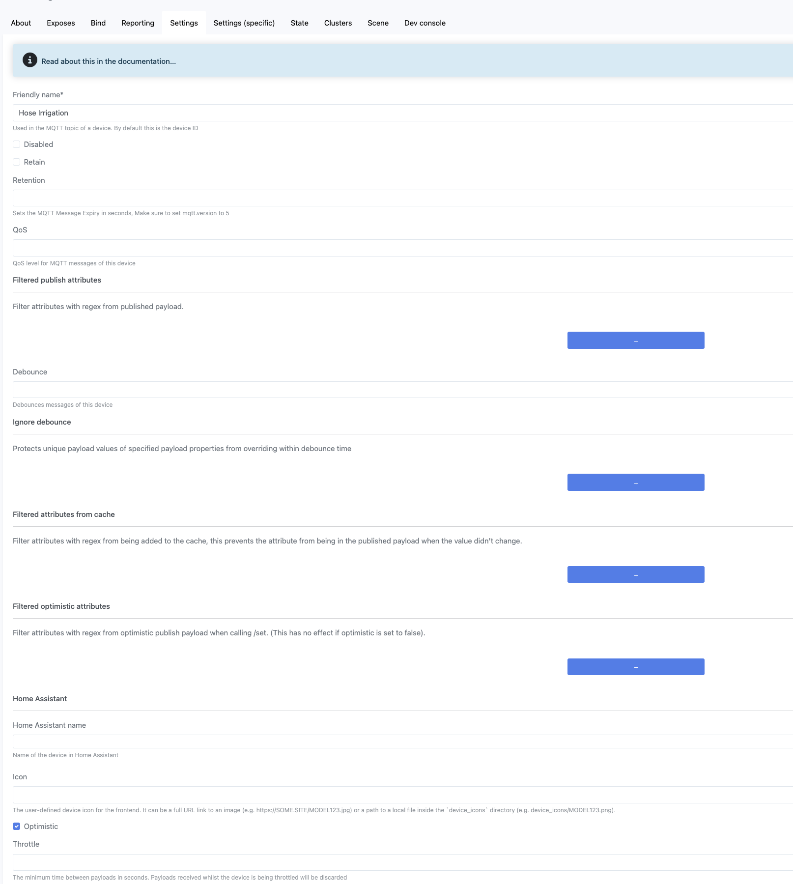

ok, curious if anyone can shed light on this. I tweaked the above a little bit and now have it firing twice a day. Plus the option to manually trigger for 5 minutes. I was hoping it would provide persistence as described above and did while on my desk. Traces are fine however logs are weird with the mqtt sent:
Hose Irrigation Cyclic timed irrigation changed to {‘current_count’: 1, ‘irrigation_duration’: 420, ‘irrigation_interval’: 86400, ‘total_number’: 100}
but then
Hose Irrigation Cyclic timed irrigation changed to {‘current_count’: 1, ‘irrigation_duration’: 495, ‘irrigation_interval’: -1078132736, ‘total_number’: 100}
I’ve not played a lot with tweaking mqtt - I’m wondering if the retain or debounce might be useful
z2m config
(the signal is actual 130 according to maps - its 2ft from a router)
logs
latest firmware and everything else
automation

My experience is: what you send to valve does work, even if what you read back immediately afterwards is senseless.
As long as you use timed triggers on HA side to open the valve twice a day, you won’t need additional cycles of the valve itself.
Different durations for morning and evening anyway could not be handled by the valve.
So in your payload you could set “total_number”:1 and “irrigation_interval”: 1, as long as each watering is started by HA, as you created it.

Water problem = no water flow detected through valve
Leak = very small / trickle type flow through valve.
Personally I don’t use either because of the use case, and prefer to use proper leak sensors to detect water leaks.
