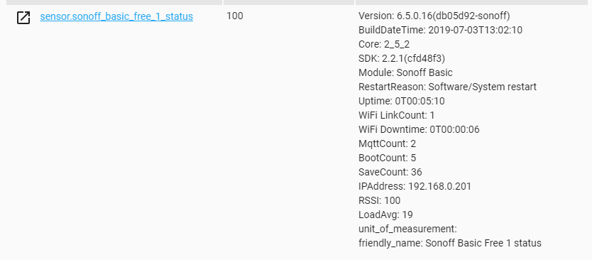

Thanks, I broke the status when I tried to do some manual footwork, then after the upload of the new firmware I did not run “SetOption 19 1”, have just done that and I now have the status.
Some good news though 6.5.0.16 with core 2.5.2 seems to have fixed the issue (have not seen a drop since the update) - the large unavailable was when i had it unplugged, the 1 small section on the right where it was unavailable was core 2.3.0
Side note: I now have 2 switches for the same device, I assume its a better approach to use “SetOption19 1” and not create each one manually (which was my original approach)
  • Not worried about this now as going to start from scratch when the new SD card arrives (will also add the automation for SetOption19)
