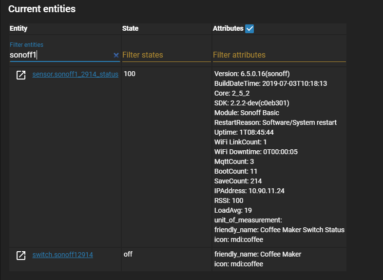

What do you see in the status object for the switch? It will list MQTT and WiFi connects in there. It is also possible that you ill get a better result with core 2.4.2 or 2.5.2. Admittedly there is only one person on the forums I have ever seen that has a stable MQTT with core 2.4.2…

For Status Object - is it this that you looking for?

No this… (the second one) see it shows the MQTT and Wifi connections
Sorry I am a bit lost (NOOB stupidity), but how do I get that view/info?

This is from dev-tools… it’s all there with the firmware version you just installed.
