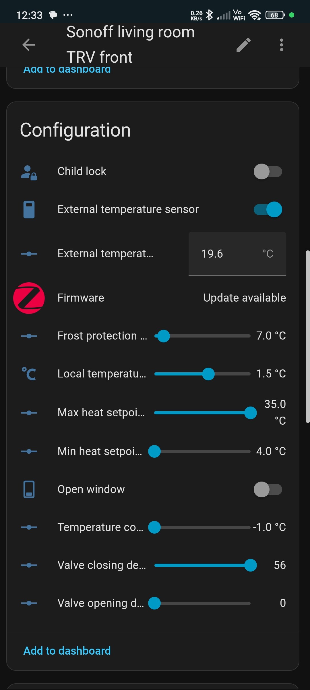

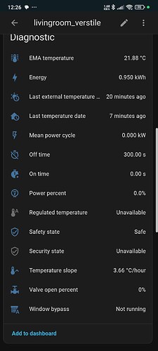

. Despite me manually moving the slider it is still not closing. The Versatile thermostat despite asking for zero percent valve open is not able to fully close the trv.
My VT setup is that the central boiler is controled via a shelly switch by HA. Each room has their own VT configured to operate the sonoff trv climate entities in “direct control over value”. The living room has 2 Sonoff trv configured under a single VT. The problem is that despite the VT asking for zero percent opening of valve the sonoff doesn’t get commands to fully close the valve (see screenshots of the Sonoff valves not fully closing). I am not sure why this is happening and what can I do to fix it.
The trv are responding via ZigBee and are reachable. Would appreciate any help
