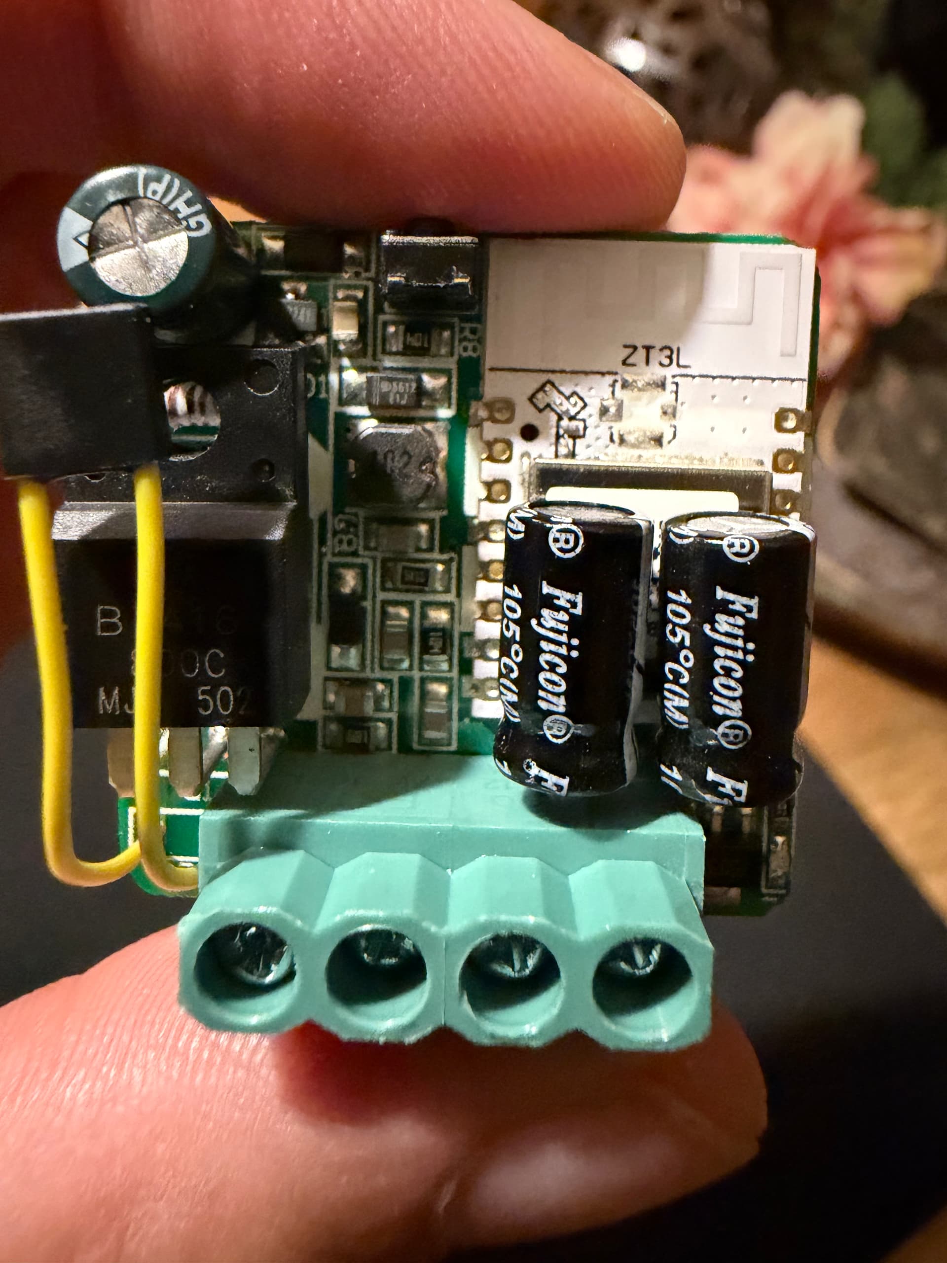

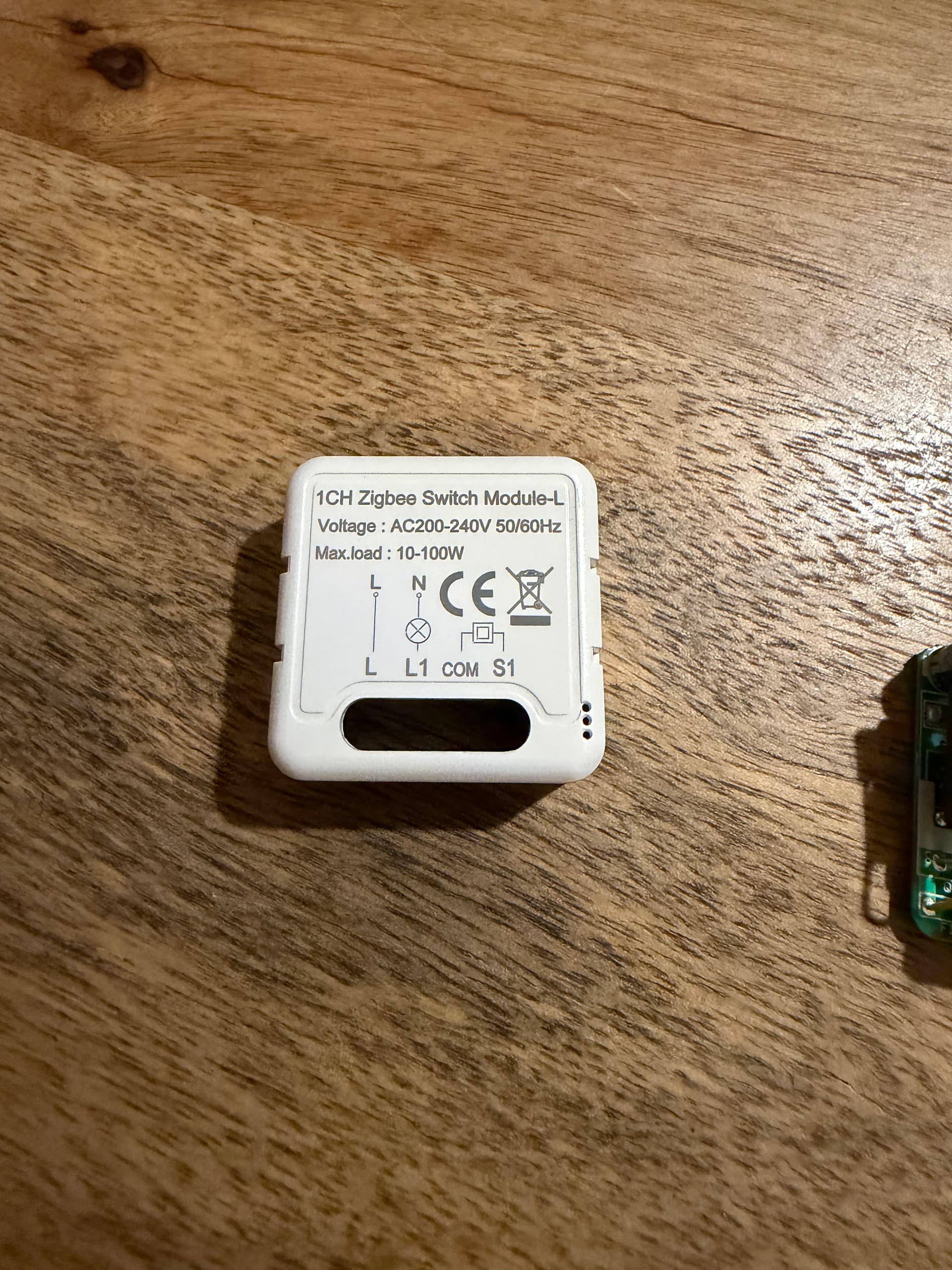

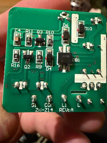

I have this one. They have the same principle. Any idea if I can do this the same?

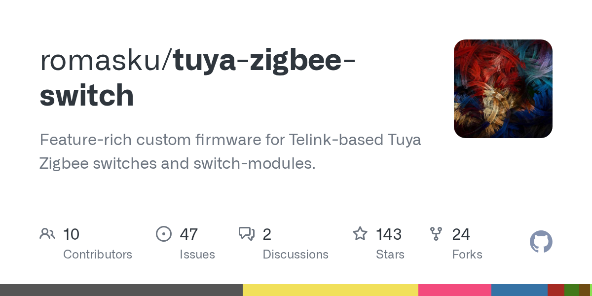

Another option is flashing with custom firmware that should enable detach relay, binding and other features
