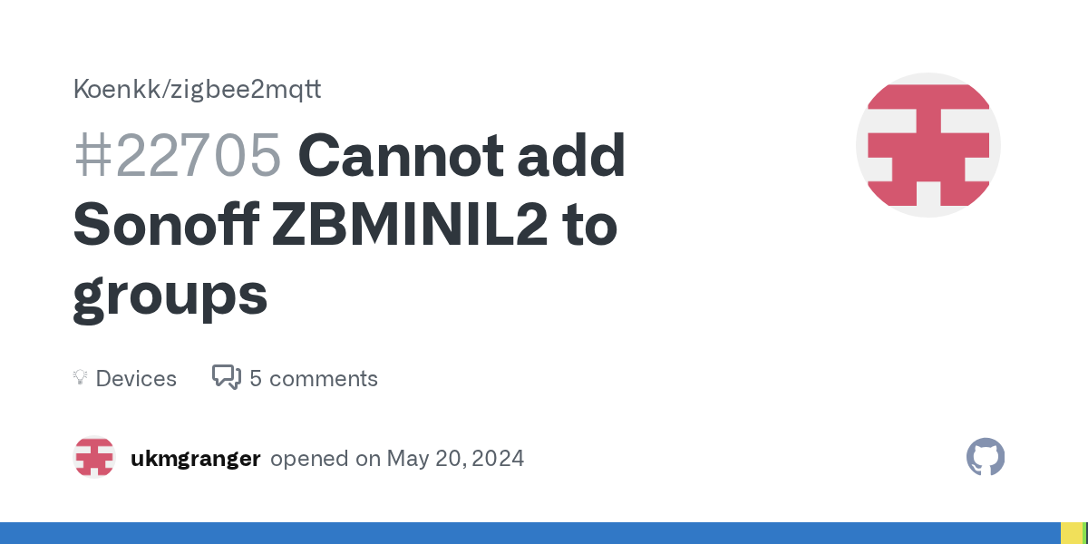

In one of the github posts on this subject, sonoff have responded as:
On Dec,24th 2025, SonOff Responds me this :
Dear Sam,
Thanks for your email.
To avoid unexpected shutdowns due to insufficient power, single-fire devices need to be as energy-efficient as possible and will enter sleep mode; thus, they do not support group operation.
Thanks for your time!
Regards,
Aron in SONOFF
