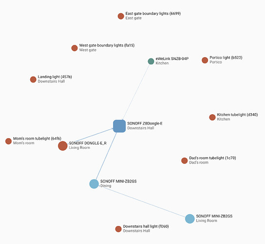

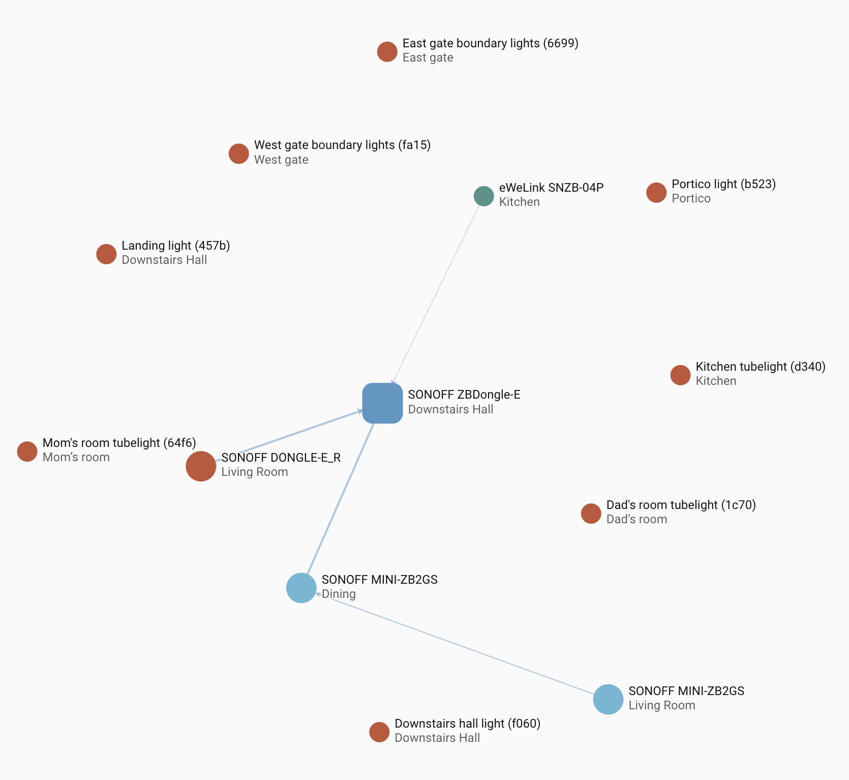

I have a simple network of mostly Sonoff ZBMINIL2s and a couple of routers (screenshot below). I recently had to re-create it and since then all of my 8 ZBMINIL2’s keep dropping off 10 - 20 minutes after I turn them off. In the debug logs, this is the consistent pattern for these devices

Devices in network
  1. SONOFF ZBDongle-E (coordinator) on Intel NUC (HAOS, no VM) with USB ext cable
  2. Sonoff MINI-ZB2GS (x2) - no clear line of sight, but 100% stable
  3. SONOFF ZBDongle-E flashed with router firmware (100% stable)
  4. Sonoff ZBMINIL2 (x8) - all offline
  5. Sonoff eWeLink SNZB-04P door sensor (100% stable)
All device firmware are up-to-date.
