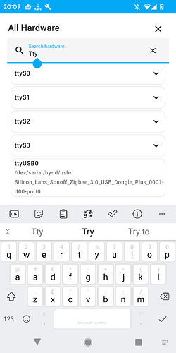

Use the ‘by-id’ string found in HA’s “all hardware” for the stick…
Example:
/dev/serial/by-id/usb-ITead_Sonoff_Zigbee_3.0_USB_Dongle_Plus_2cc5f45bfe3aec119e269e957a0af07f-if00-port0
Zigbee2MQTT works with the “byid” path. I’ll try tomorrow if it keeps working after plugging in the ESPHome device as well.

On the page with the 2 charts, there is a button with 3 dots in the top right corner. Click that, and then “all hardware”. There you can find the string to use instead of /dev/ttyusbX
