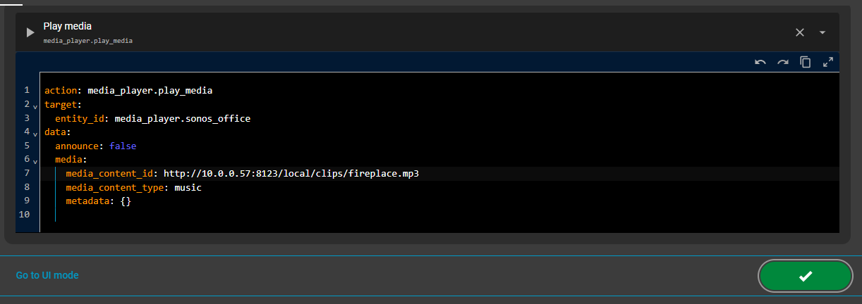

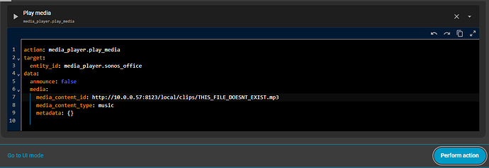

I have no idea why this isn’t working for me:
…when I have the files sitting in /www/clips. Any ideas?

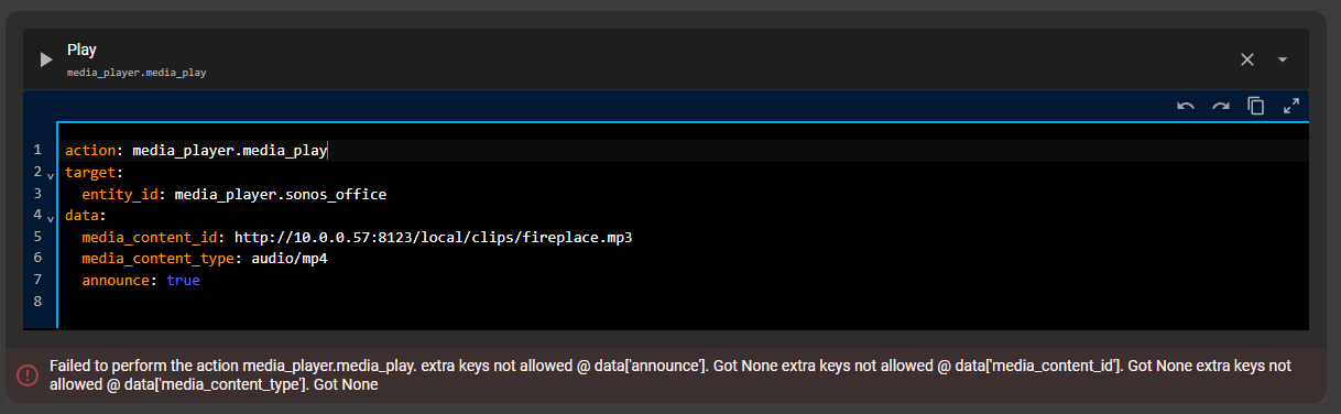

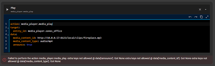

You are using the wrong action. Should be play_media
Seems that way!

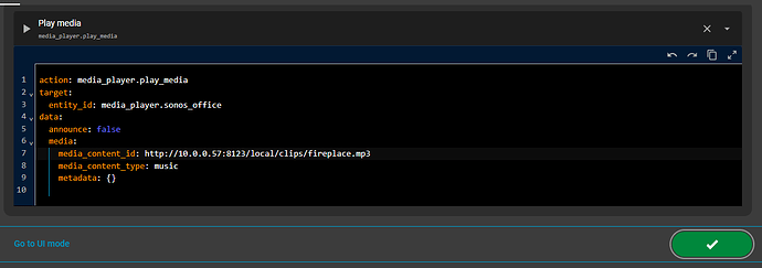

So, this does not actually play the clip:

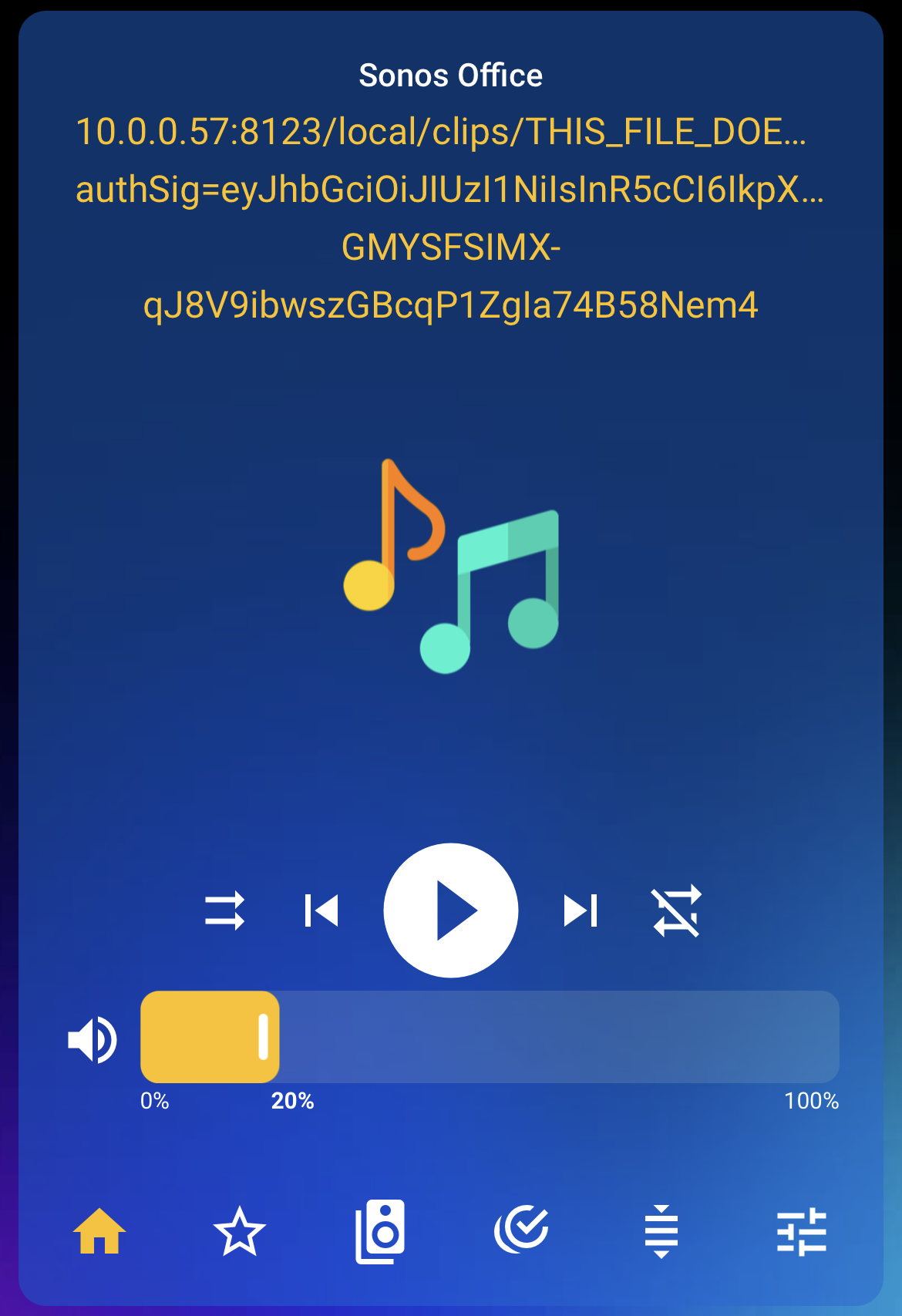

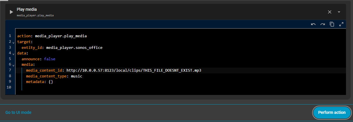

I can see the content being sent to the Sonos player… but in fact it doesn’t matter if the file is even valid. If I change the name of the file to something that doesn’t exist in that directory, it still gets sent to Sonos:
In any case… nothing is getting played.
The URL is either incorrect or not accessible by the Sonos speaker. Does it play in your browser if you put the URL into the address bar?
