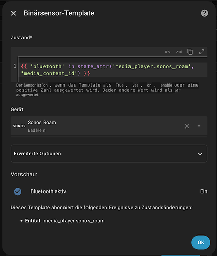

Created a template sensor based on this. Thank you very much!
