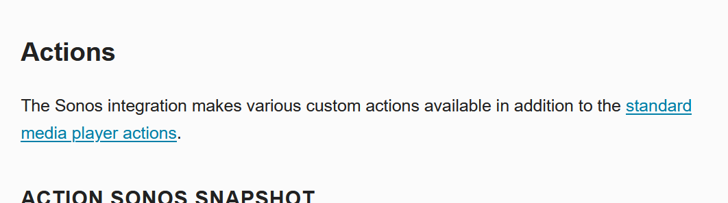

From the Sonos integration
What if you try them one by one?
And for the test it’s easier to do this with Actions under ‘Development tools’.
Sonos does not have a turn off command. It has pause and stop. If those don’t work directly from an action is developer tools submit an issue (with a debug log) and I’ll look at it.

Hi, thanks for jumping in and sharing this info about the off command, or better the lack of.
This would mean that the documentation for the integration should be updated.
Yep, we should create an issue here GitHub - home-assistant/home-assistant.io: 📘 Home Assistant User documentation
