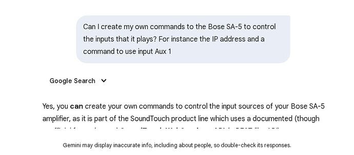

Here’s what AI advised. Any insights??
http://192.168.86.22:8090/select
Content-Type:application/xml
And in BODY I have:
[Carat Symbol] ContentItem source=ā€œAUXā€ sourceAccount=ā€œAUX_LINE_IN3ā€ isPresetable=ā€œfalseā€/ [Carat symbol → I don’t know how to display when those symbols are included ;-/ ]
The above is based on AI instructions:
I don’t know anything about home integration and haven’t added any special apps. I just want something really simple: change input, maybe on/off or volume. I’m hoping that is doable… but I’m stuck. Any help???
Thanks a million!!!
p.s. actually, I just now added the Header: "Content-Type:application/xml "
With that addition, it turns off the SA-5 unit, rather than merely deselecting the Input port.
Again, I’m trying to do this using TASKER.
