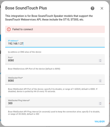

I’ve trying to connect the Soundtouch without success. I’m running HA supervised on Debian 12 with docker and when I add the integration I’ve the following error:
I made a network scan and I can see that the IP address is OK. The scan says that only ports 80, 7000 and 8080 are open for the given IP address. I’ve tried changing them without success…
Do I need something else in order to add the integration (I followed all the installation steps)?
Hi there. The Port value (e.g. Bose WebServices API Port of the device) needs to be a value of 8090. The Bose WebServices API listens for requests on port 8090. The port 8080 value is for the WebSocket port.

I have the same result if I make http://192.168.1.27:8090/info
In the screenshot you can see the port 8080 but exactly the same result with the 8090
Questions:
  1. what is the specific model number of the Bose Speaker you are trying to control (e.g. ST-10, ST-300, etc)?
  2. are you sure you have the correct IP address of the Bose SoundTouch device? Port 8090 should be open and listening if it’s a SoundTouch device.
  3. did you enter http://192.168.1.27:8090/info in a new browser (e.g Chrome, FireFox, Edge, etc) window? Just want to make sure you did not enter that into the IP Address field of the Add Device form. Can you reply with a screen capture of that output from your new browser window please?
