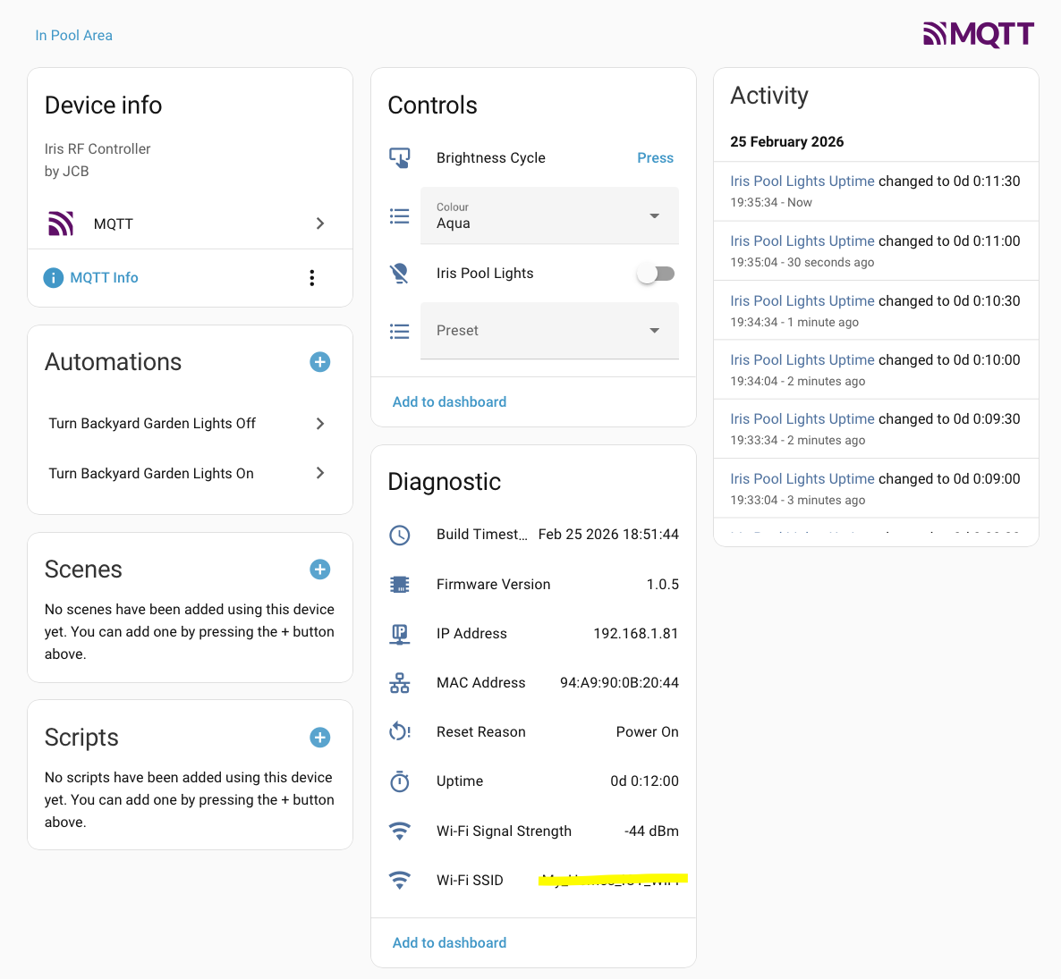

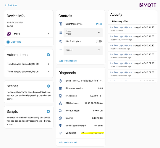

I went one step further and ended up building an MQTT integration for my IRIS Pool Lighting:
In reverse engineering my remote with SDR, I can confirm that my observations were mostly the same as @viraptor’s, noting though that the trailing 2 bytes for my remote identifier were instead 0x2D, 0x21, and that the checksum was reproducible by subtracting the “command” byte from 0xAD.
From what I could tell the 0x01 byte after the remote ID is related to the remote’s mode button, of which there are three modes according to the doc found here: https://static1.squarespace.com/static/57871ee2f7e0ab31aff6d617/t/68af95804fe441061f7bc6bd/1756337536456/RM-3H+iRIS+HANDSET_INSTALL+MANUAL_20250827_Digital.pdf, that said I did not bother capturing / confirming this as I only have the pool lights myself.
With this now in place I am finally using my pool lights, switching them on after sunset each night, along with the garden lights around the pool :slight_smile:
