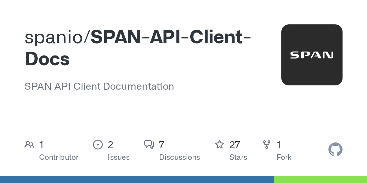

If you want to make some noise about the newer-panel timeline, the repo (GitHub - spanio/SPAN-API-Client-Docs: SPAN API Client Documentation · GitHub) asks that questions go
through GitHub issues rather than SPAN support, so that’s probably the most visible place to register interest.
