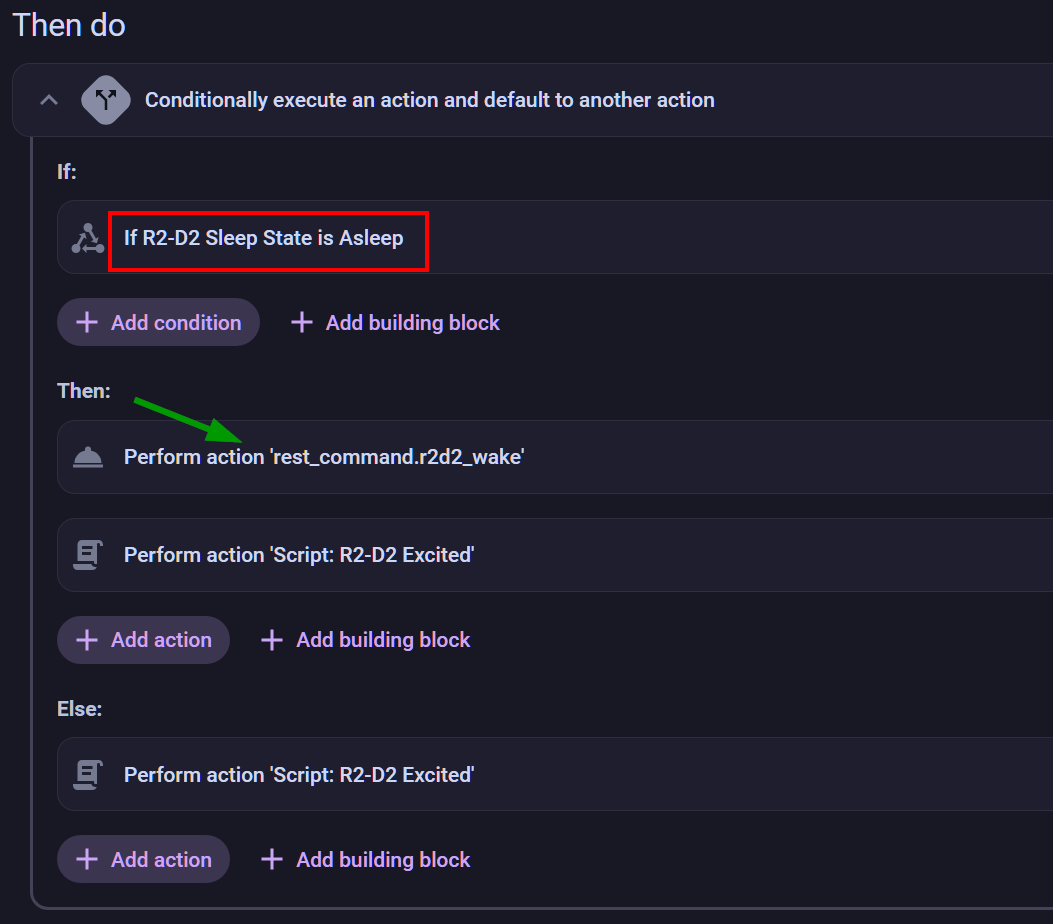

I’ve made an update to the sketch and configuration.yaml to get R2D2’s sleep and connected status over the API.
This is useful in automations so that you can check R2D2’s status before sending an animation command. If he’s asleep, you wake him first and then send the animation.
Badge with the status where he sleeps (conditional to show him asleep when he is, otherwise show him as awake)
Example:
