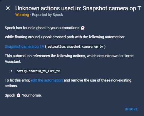

I added the SpotifyPlus integration and now Spook gives me a warning :
The script, which is correct :

Can I do something about that ?
don’t think that’s not a device_id you have in the script…more likely an entity_id
AFAIK a device_id is something like this 5447649936cb1b93398c28ca8aa928d7 that is system generated by HA
If you go to /config/devices/dashboard in your HA and click a device in there you’ll see the corresponding device_id in the URL for the page you go to.
@Tsar
I’m not familiar with Spook, so can’t say for sure. My guess is that Spook thinks the device_id argument value is some sort of HA device / entity id that should correspond to some sort of registered device maybe? Best guess.
Either way, you can ignore the Spook warning / error message, though not sure if you can configure Spook to ignore / disregard the cause or not.
The device_id in question is actually a device name ChromecastAudioLiving. Note that the device_id argument of the spotifyplus.player_media_play_context service can accept either a Spotify Connect device name (e.g. ChromecastAudioLiving) or a device identifier (e.g. abcdef12345678901234567890).
UPDATE:
Per the Spook Documentation, there does not seem to be a way to ignore this message. Maybe an opportunity for the Spook developers to add some functionality to whitelist / ignore specified scripts maybe?
UPDATE:
Just noticed the obvious Ignore button at the bottom of the Spook warning dialog. Did you click that to ignore the message? If so, does it keep reappearing whenever you reboot / restart Home Assistant?
AFAIK Spook is creating a standard HA Repair notification so if you click Ignore it does just that until you un-ignore it (via overflow menu in /config/repairs)

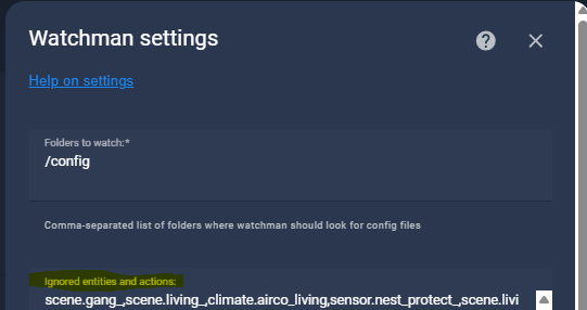

A white-list like the Watchman integration has would be nice.
