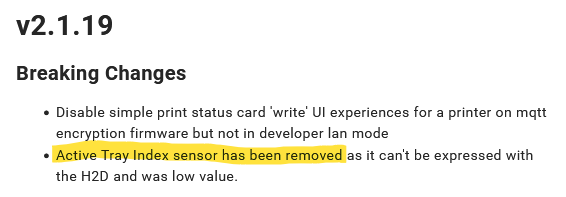

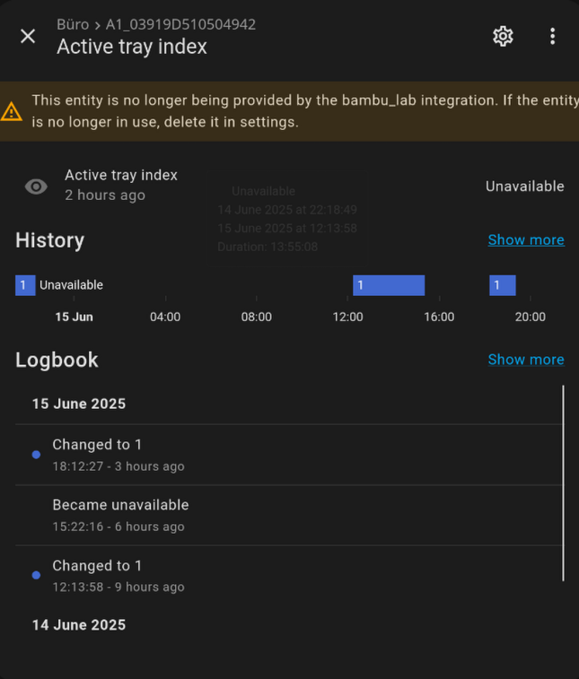

I just updated the BambuLab Integration and wanted to give you a headsup, that the active Tray Index entity is no longer provided. This is propably going to cause some Problems for the automation.
Yeah I saw
But there is another sensor in its place. Currently on Vacation so I cant take a look. I would recommend not upgrading
Thanks for your efforts, enjoy your vacation. we can survive with out updating ![]()

I’ve build a solution to the Tray Index with a additional template sensor. This is the config i have tested and working right now:
Please note that i’ve added the code below to 1 file as a package.
