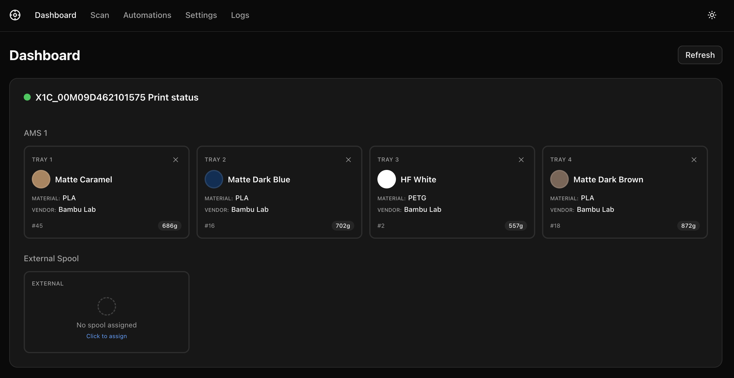

  • :printer: Automatic filament usage tracking when prints finish
  • :bar_chart: Real-time dashboard showing your AMS trays and assigned spools

:camera_flash: Screenshot

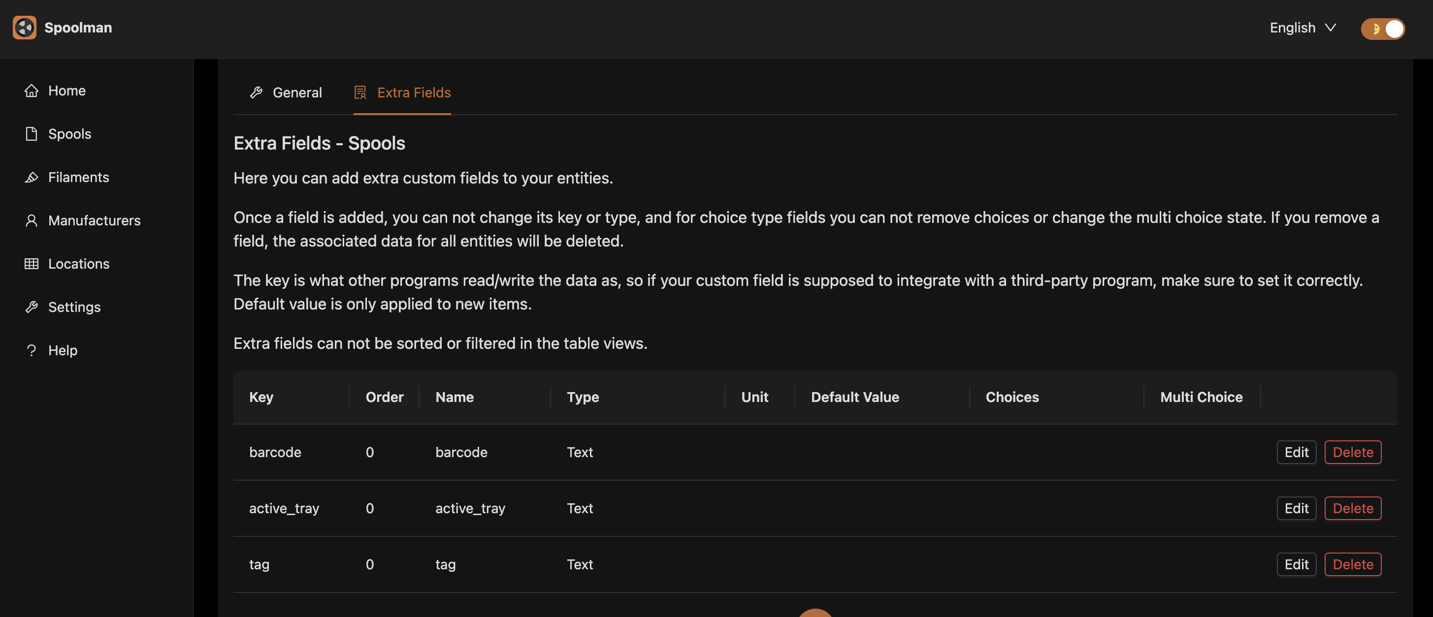

What a great idea! I’m new to Bambu (A1 and AMS Lite) and 3D printing since Christmas, but a long time Home Assistant user.
I’ve got everything up and running, but when I try to assign a filament to Spoolmansync tray, I get a “Failed to Assign Spool” every time on every tray.
I’ve looked at your github documentation and the spoolmansync logs, but get no hints. Any thoughts?
Thanks for trying out SpoolmanSync! Let’s see if we can figure out what’s going on.
The spool assignment is handled between SpoolmanSync and Spoolman (Home Assistant isn’t involved in this step), so I have a few questions to help narrow down the issue:
  1. Can you confirm Spoolman is connected? When you click on a tray in the Dashboard, do you see your spools in the dropdown list?
  2. What’s the actual error? If you open your browser’s Developer Tools (F12), go to the Network tab, and then try assigning a spool again, you should see a failed request to /api/spools. Can you share what the Response body says?
  3. Docker logs: Can you share the output of docker logs spoolmansync-app? There should be more detailed error information there.
  4. Spoolman version: What version of Spoolman are you running? The version should be shown at the bottom of the Spoolman homepage.
  5. Spoolman URL: What URL did you configure for Spoolman in the Settings page? (Just want to make sure there’s no network/URL issue between the containers)
Also, just to confirm - the A1 with AMS Lite should work the same as the X1C with AMS (what I tested with) for this functionality, so that shouldn’t be the issue here.

Error assigning spool: Error: Spoolman API error: 400 - {“message”:“Unknown extra field active_tray.”}

Thanks, those logs were helpful!
SpoolmanSync uses a Spoolman custom data field called active_tray to track spool-to-tray assignments. Your logs show that this field doesn’t exist in your Spoolman instance. You can confirm this by going to Settings → Extra Fields → Spools in Spoolman. Below is a screenshot from my instance showing the field configured:
I originally thought these were default Spoolman fields, but they’re not. I must have created them in the past for another app.
The fix: You can manually add an Extra Field called active_tray on the Spool object in Spoolman. However, I’ve just pushed a change to SpoolmanSync that automatically creates the active_tray and barcode fields via the Spoolman API when you connect (if they don’t already exist). You’ll see these logs when it does so:
[SpoolmanSync] Creating active_tray extra field in Spoolman (for tray assignments)...
[SpoolmanSync] active_tray extra field created successfully
[SpoolmanSync] Creating barcode extra field in Spoolman (for barcode/QR code scanning)...
[SpoolmanSync] barcode extra field created successfully
This should prevent the issue for others going forward.
Regarding the 0.0.0.0:3000 URL issue when connecting to an external Home Assistant instance – this was a separate bug. In Docker environments, the app was incorrectly using the server’s internal bind address instead of the actual host address you accessed it from. I’ve fixed this by using the HTTP Host header to determine the correct callback URL.
Let me know if this fixes the issues!
Thank you so much! That extra field took care of it! GREAT WORK!!
Hey! First, quick apology - I haven’t tested the new bind-mount images yet (waiting for my current print to finish), but wanted to report another finding while SpoolmanSync is working great otherwise! :blush:
Maybe I’m missing something here but I noticed the following:
SpoolmanSync receives the Bambu tag_uid from Home Assistant but doesn’t write it to Spoolman. This prevents automatic spool matching from working after first use (I typically don’t read out the tag_uid, when adding a spool to spoolman.
What SpoolmanSync receives from HA:
  "event": "spool_usage",
  "name": "Bambu PLA Basic",
  "material": "PLA",
  "tag_uid": "5D49443500000100",  ← Received
  "used_weight": 86.49,
  "color": "#8E9089FF",
  "active_tray_id": "sensor.x1c_00m09a391700764_ams_1_tray_1"
What SpoolmanSync writes to Spoolman:
  "spoolId": 4,
  "usedWeight": 86.49,
  "trayId": "sensor.x1c_00m09a391700764_ams_1_tray_1"
The tag_uid is received but not stored in Spoolman (e.g., in the tag field).
Without the tag_uid stored in Spoolman, automatic matching can not work. Please correct me, if I’m wrong here.
Suggested workflow:
If the tag_uid were stored on first manual assignment, the workflow would be perfect:
  1. First time: Manually assign spool in SpoolmanSync → at triggered update stores trayId AND tag_uid in Spoolman
  2. Next times: Move same spool to different tray → HA sends tag_uid → SpoolmanSync matches by UID → automatic assignment :white_check_mark:

Possible Bug: Embedded Home Assistant only detects first AMS unit (AMS1), not second unit (AMS2)
I did some more testing and found out that there is a problem when I print from my second AMS unit.
As mentioned before I have a X1C with 2 AMS units connected.
Problem
I reconfigured the automations in Home Assistant and discovered in the logs that it only creates entities for AMS1 (4 trays) and the external spool. AMS2 trays are completely missing. But in the SpoolmanSync App the AMS2 trays are visible.
Test Results
So I printed the exact same model from 3 different trays to isolate the issue:
Print Tray Used Usage Tracking SpoolmanSync Update
1 AMS1 Tray 4 (Marine Blue) Track 0.45g usage :white_check_mark: Tracked correctly :white_check_mark: Deducted 0.45g from spool #38
2 AMS2 Tray 1 (Charcoal) Track 0.47g usage :cross_mark: Reports to wrong tray :cross_mark: Deducted 0.47g from spool Marine Blue #38
3 AMS1 Tray 2 (Dark Brown) Track 0.45g usage :white_check_mark: Tracked correctly :white_check_mark: Deducted 0.45g from spool #7
HA Entities Created on Startup
✅ sensor.x1c_xxxxxxxxxxxxxxxxx_externalspool_external_spool
✅ sensor.x1c_xxxxxxxxxxxxxxxxx_ams_1_tray_1
✅ sensor.x1c_xxxxxxxxxxxxxxxxx_ams_1_tray_2
✅ sensor.x1c_xxxxxxxxxxxxxxxxx_ams_1_tray_3
✅ sensor.x1c_xxxxxxxxxxxxxxxxx_ams_1_tray_4
❌ sensor.x1c_xxxxxxxxxxxxxxxxx_ams_2_tray_1 (NOT created)
❌ sensor.x1c_xxxxxxxxxxxxxxxxx_ams_2_tray_2 (NOT created)
❌ sensor.x1c_xxxxxxxxxxxxxxxxx_ams_2_tray_3 (NOT created)
❌ sensor.x1c_xxxxxxxxxxxxxxxxx_ams_2_tray_4 (NOT created)
