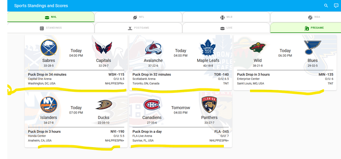

Click on a game (or a button below the game) which would turn on my television and jump to that exact game.
Yes you are neerly right.
Now I have make a picture (sorry for the bad live Button I don“t have on at the moment so I paint it)
In one image I’d like to show the box of all the favorites whether the game is in the future, past or live.
But I still don’t quite understand how setting a favorite via the Teamtracker integration should work. with your code I create the sensors for each team in the NHL and no longer with the teamtracker integration, right?
I hope now it es a bit clearer.
Ok I understand now. I couldn’t use something like that because I’m from Germany. But I can well imagine you in America :blush:

I think thats ok. You are right, its not perfekt, because (you can see in the screenshot) I have two times the Game Kranken and Sharks (because Kraken and Sharks are two of my favorites.
I have now created a new Games sub-category and then the new Favorites category and the already existing Postgame, Live and Pregame
I’ve combined it with your code now and it looks like this:
