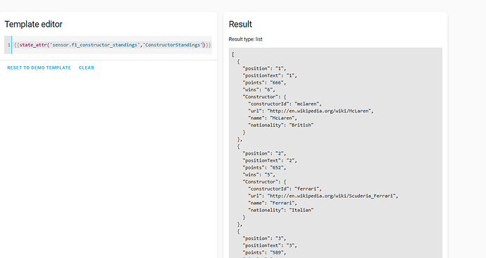

And this is what I am showing:

Start with data please. Do you actually get any data like above?

yes, i get the data, just no output

When I copy your code and put it into a new/blank dashboard I am seeing data - see below. I have not altered your code, I am using Kbrown’s NHL sensors and I am using the F1/NASCAR sensors I posted in this thread above.
