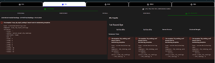

Hi All,
I have read through the forum but still not seeing data coming in. I think there is something definitely wrong with my config. I am running HA-Core.
That being said let me get into it.
PreREQs:
  • I have installed all GUI needed
  • I have created fresh sensor file
  • I have updated my code on UI with latest dashboard code
I am still not able to see data currently:
My current config:
**I set up for in future if I want to add more sensors
Finally:
I am using this Dashboard YAML here => [SportStandingsScores/dashboard.yaml at 2fad100bfe50edaf8ed4bd82b461465c1215851b · kbrown01/SportStandingsScores · GitHub]
Kindly trying to find what I am missing, as I feel its something big.
Thanks for any help in advance.
Sorry I am new user, so I was not able to post a lot of photos, due to being new!
define

Hey I updated my photo above, my apologies there and currently in entities it does not exist which is one of my problems.
Okay - so if You follow what @kbrown01 has you will need to make sure that your template.yaml file has the conferences. Make sure you grab his template.yaml from his github - at the top of this thread.
I moved the conferences from templates.yaml to my sensors because I ran into a limitation with Templates in college football. So I have moved away from templates.
So either use kevin’s template.yaml config or put the following in your sensor.yaml file.

@bburwell thanks for your work. I stumbled across the org. GitHub repo yesterday and today I saw your updated one.
But I have some questions/issues on my setup.
I uploaded all yamls from the sensor folder to my sensor folder. Restarted HA and it seems that all sensors are working fine.
I am most interested in the NFL ones so I focus on NFL now.
I created a new Dashboard + edited the dashboard via the raw editor and pasted the content of Sports_US_Professional inside.
Reloaded the page and voila it looks like it works.
BUT there are some missing things
NFL - Standings - Overall → empty site
NFL - Standings - Schedules → only Denver Broncos which I can unfold, but empty again
NFL - Standings - NFL Playoffs → some errors related to templates missing
NFL - Live/Pre/Post… → Empty
See below screenshots
Maybe you can enlighten me how to fix them.
Thanks!
Yeah - sorry playoffs is a work in progress - I was doing it at the same time that I was working on the NCAA CFP so didn’t really finish either yet.
As far as schedules go, I see that ESPN changed their data and they are no longer showing attendance, or rushing for the schedules. So I did a couple changes and the dashboard is updated on github.
The changes:
  • Cleaned up the Playoffs tab so no errors will show by pulling sandbox code.
Schedules Tab for NHL(added) & NFL
  • Schedules (at least for NHL and NFL) follow the same format, so I changed the NFL_team_schedules to just team_schedules
  • removed attendance
  • removed leaders
  • changed code in dashboard to call team_schedules
  • added a tab in NHL(I only have Dallas Stars in sensors, but easy enough add others)
So you should see the following:
There are only 4 teams left in the NFL season playing this weekend and Pre/Live/Post use Teamtracker to get data. Here is what I am showing today on that tab:
