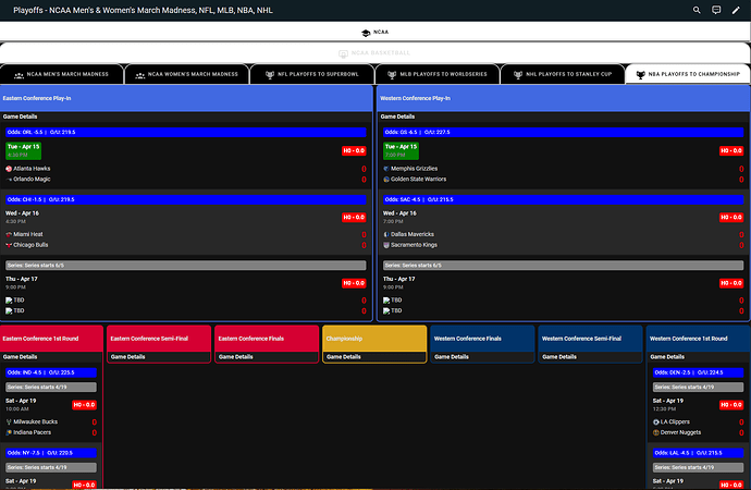

Here are a couple screenshots:
Edit:
Here is what I am seeing for NBA right now (added play-in)
Edit 2:

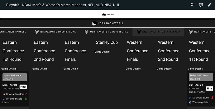

But now it looks like this:
What am I doing wrong?
So First round pulls from the python files because if I use templates HA barks. I explain it in the readme a little bit.
You will need to put the python files in config/www directory and then change the configuration.yaml like I call out and then create an automation that calls the json files.

I’m now seeing data, but there’s still something wrong with the layout. What else might I be doing wrong?
And I also tried the second version Grok.
All json files were created.
but the data is not displayed to me:
Great you’re almost there. Nicely done.
So your 2 separate asks:
1st Ask - I am actually cheating with the Flex-Table Card and just using 1 column. An idea I stole from @ehcah. Data is sent to the decluttering template and it builds the code inside the single cell. I am wrapping a border around it with card-mod. The color I am picking is in the variables in the dashboard. For example with NHL Eastern Conference Playoffs the color is ‘#D50032’. So you need to make sure that these variables are in there if you want the border and color of your choosing.
                                        variables:
                                          - title: Eastern Conference 1st Round
                                          - color: '#D50032'
                                          - entity: sensor.nhl_playoff_east_1st_round
                                          - events: events
                                          - show_rankings: false
                                          - show_series: true
                                          - show_broadcast: true
2nd Ask - So right now only the 1st round json files are being populated by ESPN and they haven’t put data into the next rounds yet and I based the structure on last years data. Hoping I wont have to tweak it but yet to be seen.
  • First step is make sure the files in the /config/www/*.json files have data in them. Specifically look at nhl_west_1st_round_gpt.json or nba_west_1st_round_gpt.json.
  • The First few lines in that file should look like this:
  "sport": "NHL",
  "events": [
      "id": "401768100",
      "uid": "s:70~l:90~e:401768100",
      "date": "2025-04-19T22:00Z",
      "name": "St. Louis Blues at Winnipeg Jets",
      "shortName": "STL @ WPG",
      "season": {
        "year": 2025,
        "type": 3,
        "slug": "post-season"
      "competitions": [
          "id": "401768100",
          "uid": "s:70~l:90~e:401768100~c:401768100",
          "attendance": 15225,
  • As long as that looks correct, I am guessing you haven’t added the sections in the nhl_sensors.yaml or nba_sensors.yaml to pull the code into the sensors.
  • Make sure that you update the IP with your own HA IP
  • So confirm that you have the sections in nhl/nba_sensors.yaml (cleaned up the github to show the code between the ############################ gpt #################### comments.
  • The other step is you need to create an automation that updates the sensors. I have updated my github readme to show NHL automation calling the python files as well. This automation only runs durning the playoffs. I have one for NBA as well.
Flow is:
  • Automation calls Python files
  • json files are created/updated
  • sensors in nhl or nba monitor the json files and update their respective sensors (1st Round/2nd Round/etc.)
  • Dashboard updates based on sensor data.
  • Customization can be done with variables or just going into the code and tweaking.
Hope this helps.

ok now I get data.
but it simply cuts off on the right at the Western conference:
Regarding the color in the other case, I entered this code:
border: 2px solid #D50032;
I have already cleared the cache
but it still shows it like this:!
I just re-uploaded the Playoff Updated - March Madness NCAAM,NCAAW,MLB,NFL,NHL,NBA,WNBA dashboard. Try pasting that over your current one and see if there was something askew.
From a formatting perspective on the GROK daskboard, I put everything on a large screen, since I primarily am at my PC vs on a phone. So it is not optimized. It shouldn’t split like that though. If I shrink my browser it looks like this:
. Ugly but uniform split
If you wanted to make everything vertical then under cards change
  • expanded: false
    cards:
    - type: horizontal-stack
    to
  • expanded: false
    cards:
    - type: vertical-stack
  card:
                                cards:
                                  - type: custom:expander-card
                                    title: NBA PLayoffs 1st Round
                                    icon: mdi:basketball
                                    expanded: false
                                    cards:
                                        cards:
                                          - type: custom:decluttering-card
                                            template: sports_playoffs_series_gpt
                                            variables:
What happens if you change the card_mod in the decluttering_template to this?
 card_mod:
        style:
            ha-card {
              overflow: auto;
              border: 2px solid [[color]];
              border-radius: 8px;
            .card-header {
              background-color: pink;
              color: white;
              padding: 8px!important;
              font-size: 14px!important;
              font-weight: bold!important;
This is what I get in the GROK dashboard
So when I make the browser window as big as possible on the PC it looks like this:
But if I make it a little smaller it looks like this:
It simply cuts off on the right. Like yours, especially with the colors, it doesn’t look right for me.
