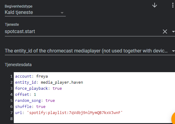

Hi @fondberg - first of all let me say - awesome work man !!!
I have an issue which I cannot understand (it may be a minor slip) - after installing from HACS the spotcast, configuring it with the cookies, from Service - Call Service with the below code it works without an issue - the music starts immediately.
code 1 which works:
Service:
spotcast.start
Entity:
media_player.office_speaker
Service Data (YAML, optional):
device_name: Office speaker
entity_id: media_player.office_speaker
uri: 'spotify:playlist:37i9dQZF1DX7cZxYLqLUJl'
random_song: true
shuffle: true
If I put the same as above in a script - Morning Alarm - it does not work anymore and throws the error in the subject

any ideas on what’s wrong with my code?
It did not work for me either - if you make an automation it will work.
Hi, can you give me an example? as if I try to call it from Services directly it works. If I want to use it in an automation - then it does not work and throws the above errors.
I send you an example later today…
this works in my automation
WOW it worked - unbelievable - thank you very much.
I think it’s because of the force_playback ? and not stating the device directly?
that was weird.
It works now. Thank you very much @ha_user22323
