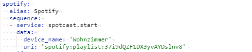

My script:
(Please don’t ask me, why sometimes I cannot post here with proper intendation, hence the screenshot)
