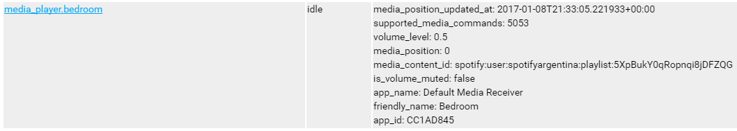

Having tried this before, I am unable to replicate your success.
I only get the player to be IDLE.
davedan
(Dave Dan)
January 9, 2017, 5:20am
15
Uhmm, weird. It works like a charm here.
What is your media player? Itās a Sonos, LMS?? Can you play that playlist directly on it (without HA)??
My media_player
is a Google Cast device. Doesnāt work on Chromecast Audio or Google Home.
