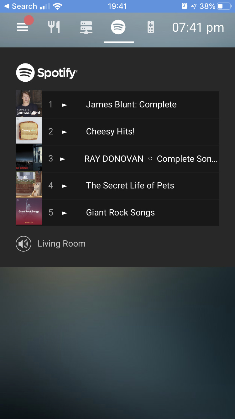

Love this card! Can’t believe I’ve just found it. Only issue after installing it is my sonos are not available from the devices list.

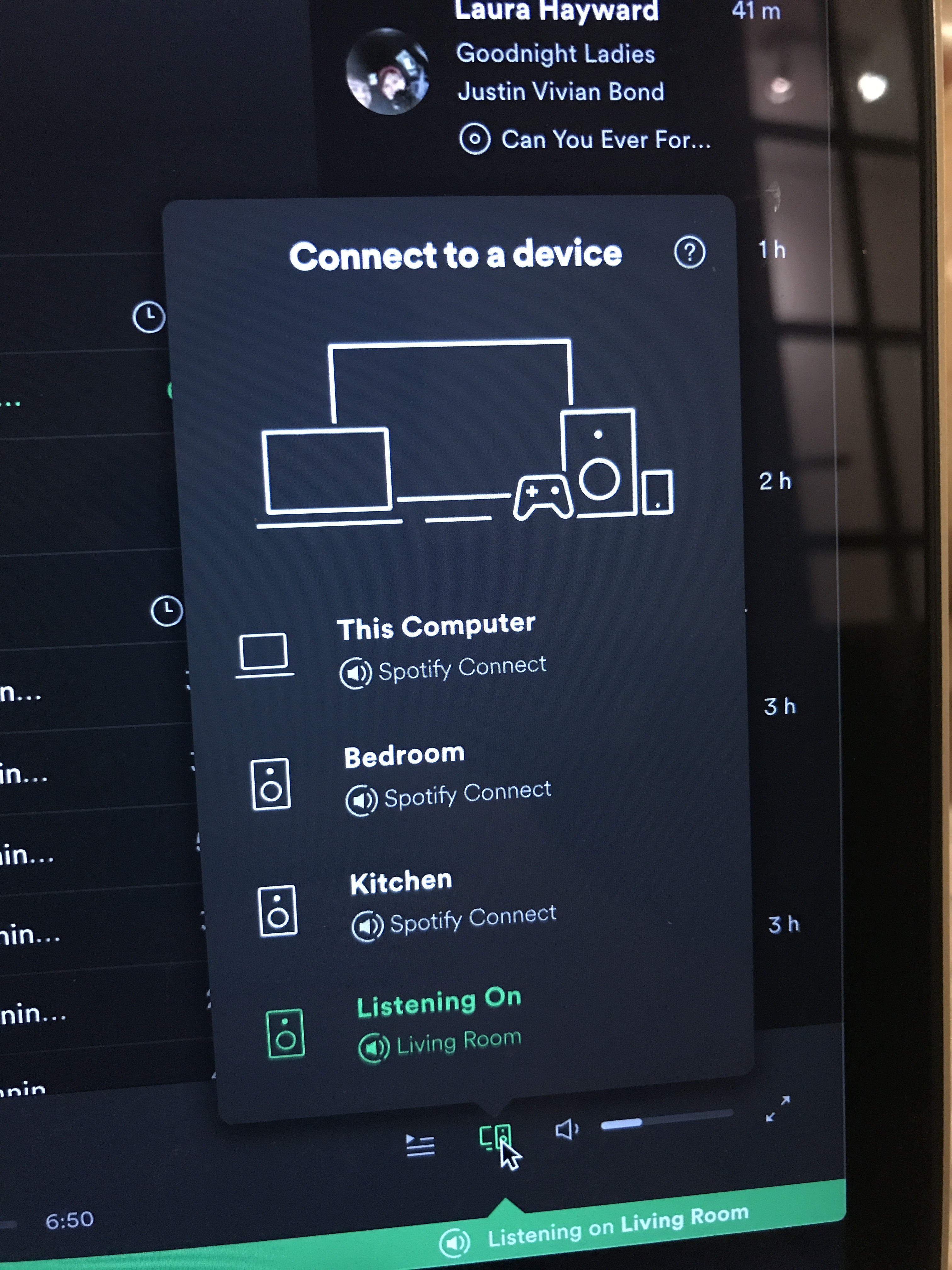

I have the Spotify app on my Mac and all three Sonos are on there and if I select one from my Mac that one appears on my card in HA but none of the others.
Here you can see the “now playing” device on the card using the HA app. I selected the living room sonos using my Mac.
And here you can see none of the sonos devices are listed?
But on my Mac using the Spotify app they are listed:

Sonos doesn’t implement the Spotify connect device api unfortunately which means support for sonos needs to be first implemented in HA and then added to the card.
Question, is it possible to start Spotify playback on a Sonos using HA service calls today?
What do you mean by “I can’t go back”? Are you hitting the back button in the browser or are you clicking a tab in Lovelace?
I have sonos integration in HA and yes I can see Spotify playlists using the media player card for a sonos
so its all kind of linking, but not sure how to add the sonos devices to your card, if thats possible
