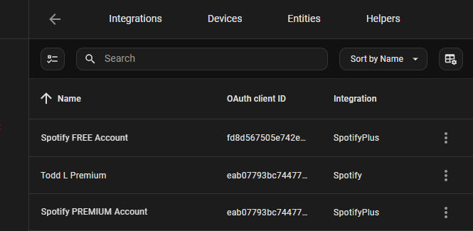

  2. Go to the Home Assistant Application Credentials settings (under Settings \ Devices, click on 3 vertical dots menu in upper right and select Application Credentials) and see if it created any OAuth application credentials related to SpotifyPlus (or Spotify if you’re installing HA Spotify). If so, delete them.
  3. Open the Spotify Web Player in a new browser window and logout of Spotify. This will force you into a logon screen the next time you try to authorize the OAuth request.

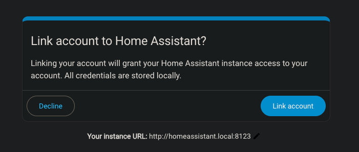

I use https://serverURL:8123 I noticed on the 'link to home assistant page my instance URL was not matching. I edited this as you described and no longer get the same error as before.

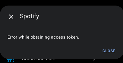

However, I am now getting the error Error while obtaining access token :
I deleted credentials and logged out of Spotify before attempting this.

Rerun the process, including removing App Credentials / Spotify Logout. You might try using the SpotifyPlus Integration Install Instructions, but just substitute the Spotify Integration (or just install SpotifyPlus if you like - it’s a direct replacement for the HA Spotify integration).

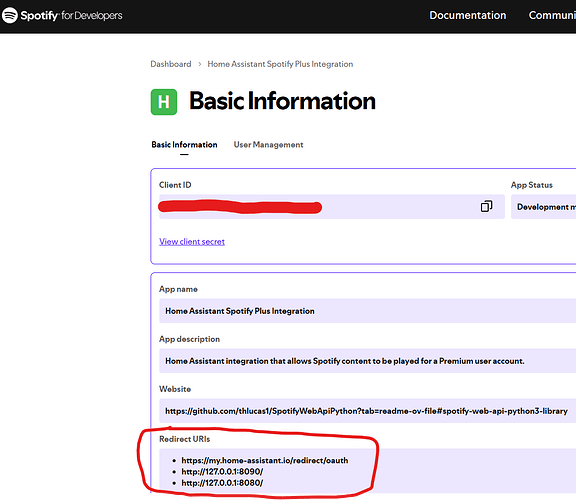

When you get to the “Link Account to Home Assistant?” screen, take a screen capture of that window, including the browser url (like my Figure 4e picture in the previous reply). I need to know what url prefix is being used for the request, as well as what the instance url is.

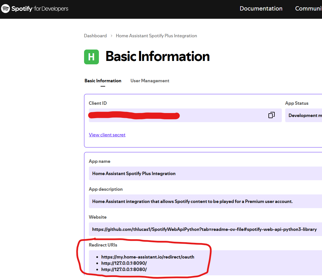

Also post a screen capture of your Spotify Developer App settings (don’t need the client id). I’m interested in what the “Redirect URIs” value looks like. It will look similar to this:

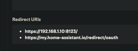

I noticed my HA instance URL was not in the Spotify dev account redirect URLs like the image you provided so I tried it with that too but I still got the same error
@Jakesa
Regarding the Spotify Developer App Redirect URIs settings:
  • https://192.168.1.10:8123 is not needed, and should be removed from the Spotify Developer App Redirect URIs settings
  • https://my.home-assistant.io/redirect/oauth matches the browser url for the “Link Account to Home Assistant?” page, which is correct.
  • Note that the http://127.0.0.1:8090/ and http://127.0.0.1:8080/ (localhost) entries in my Spotify Developer App settings are used to test other processes outside of Home Assistant, so you will not need those 2 entries.
Regarding the https://192.168.1.10:8123/:
  • is this the url that you use to access your HA instance? or do you use http://192.168.1.10:8123/ (e.g. not HTTPS)? If you are using https://192.168.1.10:8123/, then I would retry the process with the http://192.168.1.10:8123/ url. It might be running into an SSL certificate issue when trying to use the HTTPS url.

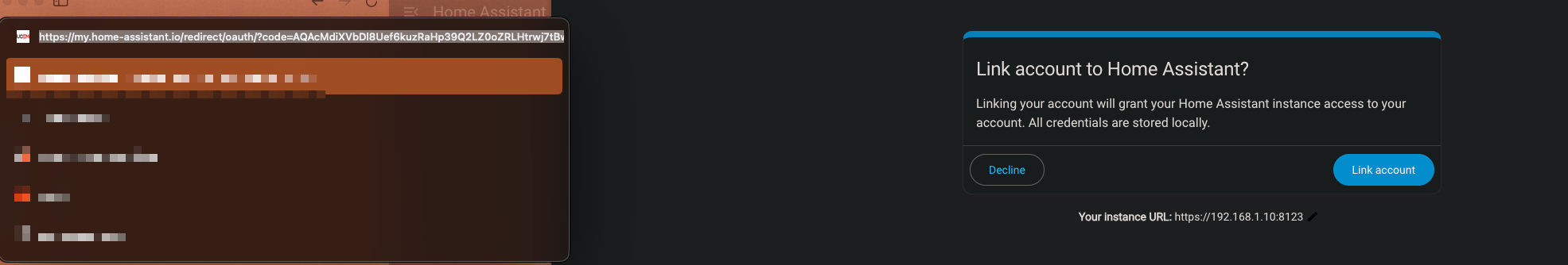

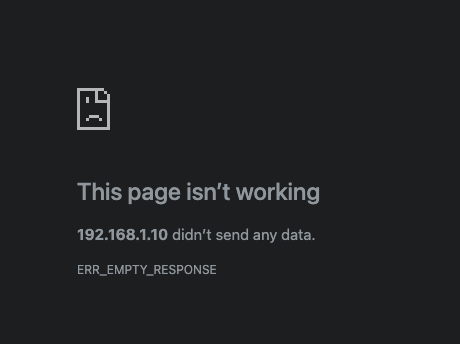

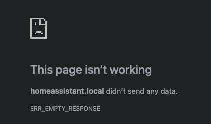

Yes I use https://192.168.1.10:8123/ to access my HA instance.

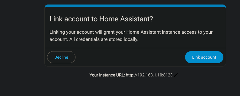

when I try the process with http://192.168.1.10:8123/:
I get the following:
@Jakesa
It appears the latest http://192.168.1.10:8123/ was a step back, and exhibits the same behavior as the https://homeassistant.local:8123/.

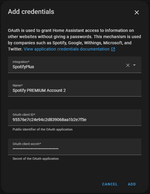

With that said, let’s try adding the HA Application Credentials manually (instead of through the Spotify integration install process).
Use the following:
***** IMPORTANT *****
You will want to clear any previous Application Credentials again, as well as log out of Spotify.
Also restart Home Assistant and clear your browser cache (including files, cookies, and images) prior to executing the following steps.
Step 3 - Home Assistant Application Credential(s)
We are now ready to add Home Assistant Application Credentials for each of the Spotify Developer Applications that were created in Step 2.
Go to the Application Credentials page to list any existing OAuth2 application credentials, as well as define new ones. This is located under Settings \ Devices & Services \ Application Credentials (have to click the 3 dots menu in the upper right corner).
Step 3a - Add Application Credential(s)
Click the Add Application Credentials button to add a new credential.
Fill in the Credential Form fields (see Figure 3a):
  • Integration: Spotify (select from dropdown list).
    Note - if you don’t see the Spotify entry in the list, then it denotes that a problem occurred with the integration installation (e.g. failed, HA was not restarted, browser cache was not cleared, etc).
  • Name: Enter a name for the credential. I would suggest using “Spotify FIRST LAST” for this value, with FIRST being the Spotify user first name and LAST being the Spotify user last name (e.g. “Spotify John Smith”).
  • OAuth client ID: The Spotify Developer App Client ID value for the Spotify User.
  • OAuth client secret: The Spotify Developer App Client Secret value for the Spotify User.
  • click Add to add the credential.
Figure 3a - Home Assistant Application Credentials Form
For multiple Spotify User support, repeat the above step for each of the Spotify Developer Applications that you created. Once you are done, your Application Credentials list should contain all of your Spotify credential entries (see Figure 3b).
Figure 3b - Home Assistant Application Credentials List
If the above worked, then you are now ready to add the Spotify integration. When you add the integration, it should allow yo uto select a pre-existing Application Credential to use with the Spotify instance being installed (assuming the above steps worked to add the credential).

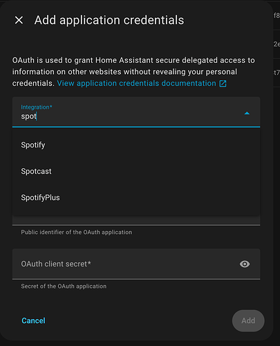

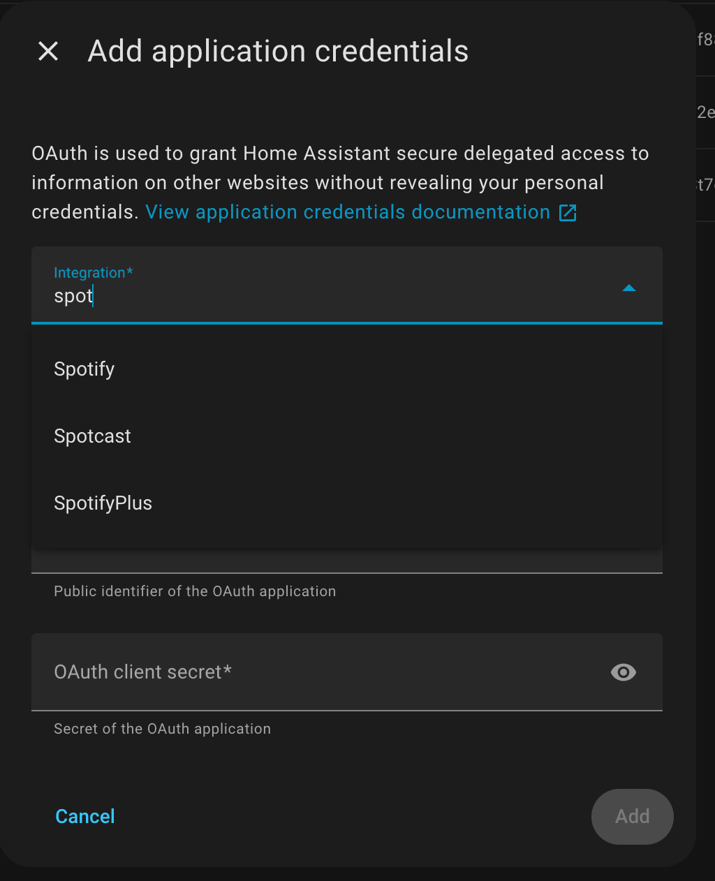

I have decided to abandon Spotcast and switch to Spotify Plus, but I seem to be encountering similar issues:
Your instructions state to select the Spotify integration in the add credentials section, but you have SpotifyPlus selected. Could you please confirm which one I should select?
@Jakesa
You should be selecting the SpotifyPlus entry in the Integration drop down list.
Since it has been a few months since you last tried this, I would say ignore the suggestions in the previous thread replies and follow the wiki documentation starting with the Pre-Installation Requirements step. There have been quite a few tweaks and updates in the past few months to the installation process. That will ensure you have your Spotify Developer App settings correct, as well as how to install the integration service.

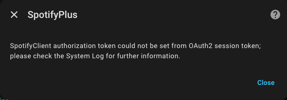

I keep hitting a brick wall whenever I try to add the integration. I can’t figure out where I’m going wrong. Each time SpotifyPlus attempts to connect to the Spotify API, I receive an SSL certificate verification failure.
I’ve followed all the steps and tried several times, deleting credentials and starting from scratch each time, but I continue to encounter the same error.
SpotifyClient authorization token could not be set from OAuth2 session token; please check the System Log for further information.

urllib3.exceptions.MaxRetryError: HTTPSConnectionPool(host='api.spotify.com', port=443): Max retries exceeded with url: /v1/me (Caused by SSLError(SSLError("bad handshake: Error([('SSL routines', '', 'certificate verify failed')])")))
  File "/config/custom_components/spotifyplus/config_flow.py", line 168, in async_oauth_create_entry
    await self.hass.async_add_executor_job(
        spotifyClient.SetAuthTokenFromToken, clientId, data["token"], tokenProfileId
  File "/usr/local/lib/python3.13/concurrent/futures/thread.py", line 59, in run
  File "/usr/local/lib/python3.13/site-packages/spotifywebapipython/spotifyclient.py", line 17931, in SetAuthTokenFromToken
    self.MakeRequest('GET', msg)
  File "/usr/local/lib/python3.13/site-packages/spotifywebapipython/spotifyclient.py", line 1458, in MakeRequest
    raise SpotifyApiError(SAAppMessages.UNHANDLED_EXCEPTION.format(apiMethodName, str(ex)), ex, logsi=_logsi)
spotifywebapipython.spotifyapierror.SpotifyApiError: SpotifyApiError: SAM0001E - An unhandled exception occured while processing method "MakeRequest".
@Jakesa
That error indicates there is something wrong with your SSL certificate chain on your client. It could be any of the following:
  • Python cannot validate Spotify’s HTTPS certificate.
  • TLS handshake fails before OAuth or /v1/me is even called.
  • Spotify’s certificate is valid, so the failure is on your system.

  1. Home Assistant OS / 2025.12.5
  2. http://192.168.1.10:8123
  3. Proxy: No, I am NOT using the official ‘NGINX HA SSL Proxy’ add-on. I do have Nginx Proxy Manager installed, but I use it exclusively for a separate add-on (Mealie).
My Home Assistant instance itself is NOT behind this proxy. I access Home Assistant locally via HTTP (http://192.168.1.10:8123).
Regarding the SSL/MITM suspicion:
I suspect you are right that something is interfering with the connection, but I have tried to rule out the usual suspects:
Router (BT Smart Hub - UK): I thought this might be due to the “Web Protect” / “Smart Setup” features built into my router, but I have disabled these features and am still getting the same issues.
AdGuard: I have also tried disabling AdGuard Home completely to rule out DNS blocking.
