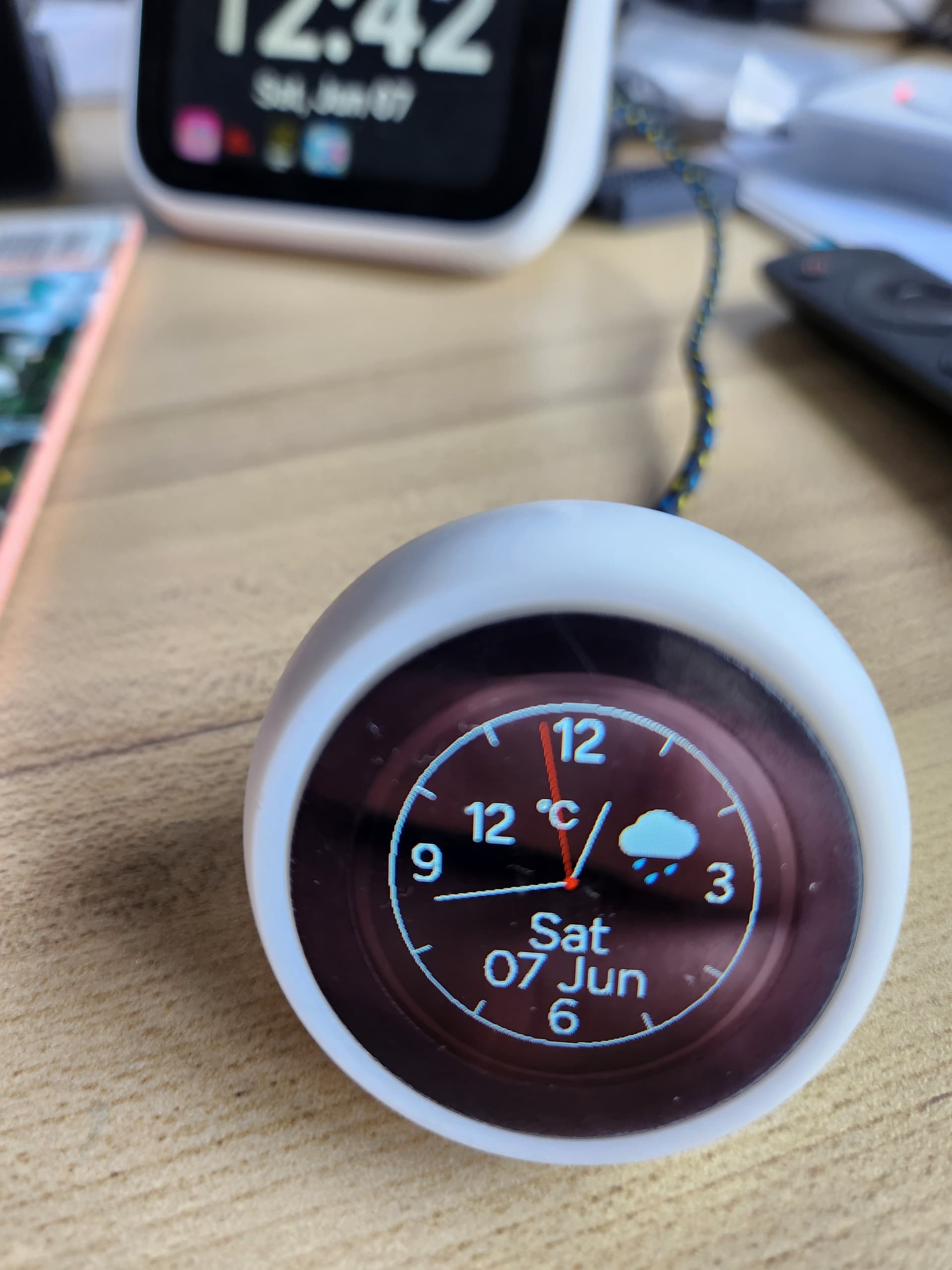

Next step is to create a clock and weather screen as the screensaver
Seems like i wasen’t exposing the fullchain cert and that’s why it was a problem.
Now over to other things like finding out why it’s veeeery slow and does nothing i ask it to :wink:
ive managed to get the clock on it, will share the code later tonight, once I have ironed out a few bugs
Update: OK so I have added the clock with weather for it, take a look here
you’ll need to copy the weather folder as well , the location you will fid in the yaml. Still a bit of tweaking to go

Nice, i still dont like the look of the clock but a bit of playing around csn fix that. Let me know if you have sny advances on the looks :grinning: i am going to change the vouce assist pics to something a bit more funky i think :grinning:

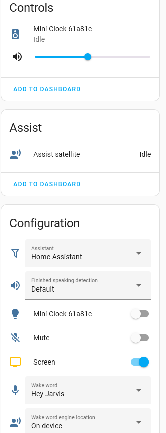

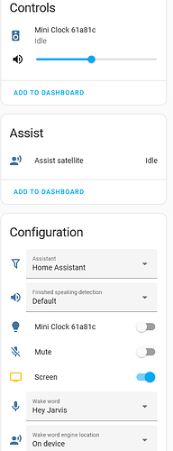

Does the voice assist really work? I tried saying “Hey Jarvis” but nothing happens on the ball
