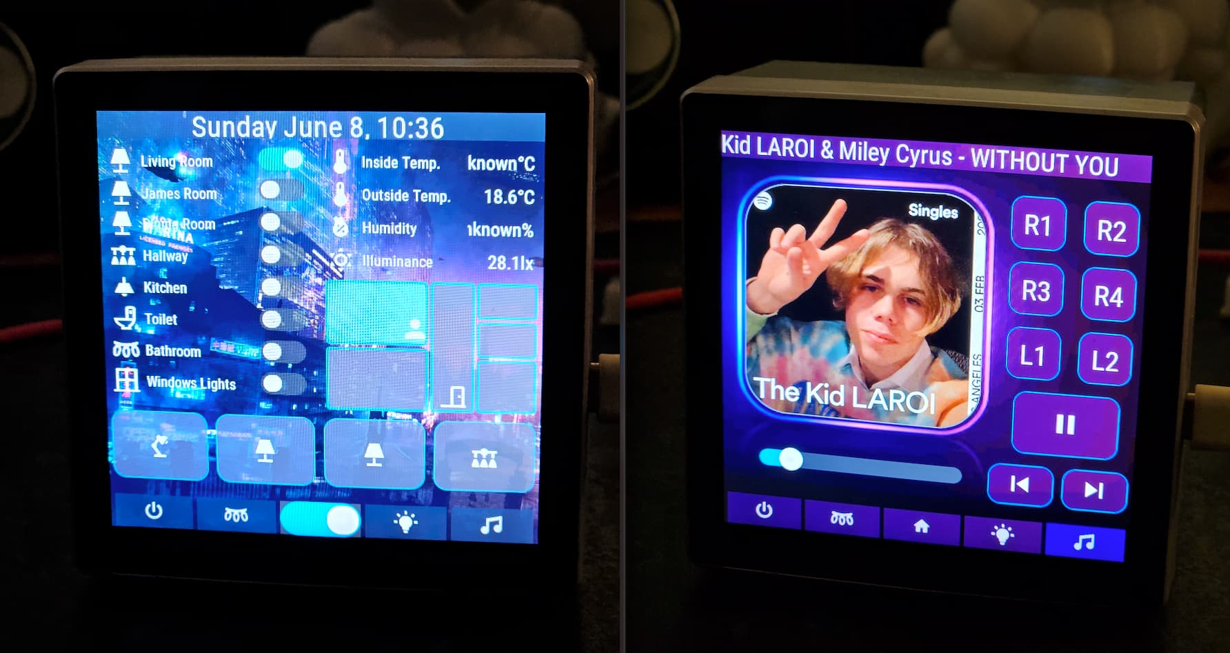

take a look at “openhasp”, it runs on esp-s3 devices and is great for larger displays with many good examples to learn from, thats how i quickly got to know LVGL.
this is a 4" display that works as the desktop control panel, it’s also a esp32-s3 inside with openhasp. it btw also has a clock :laughing:
Awesomene, thanks do much, ill take a look
