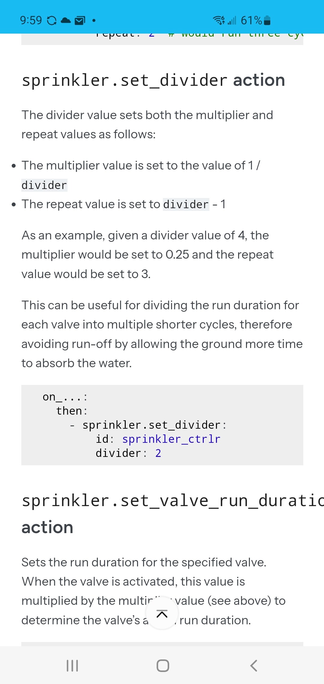

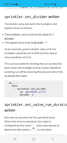

Hi All, Great project and discussion. I wish I could have your advice on repeating the cycle. Aside of the valve open delay I am missing “repeated cycle delay”. This is, for instance, to allow the ground to assimilate water before new cycle may start adding more.
Standard “sprinkler” component does not have it. How I may add one to the ESPHome solution?
I think this may be what your looking for. This doesn’t technically repeat a valve running but, what it does is say you have an area that doesn’t absorb water quickly and if you use the run time as your other valves then that area will flood or water will flow off the surface before it has time to saok into the ground.
The set-divider action will allow you to set your zone to “15min” for example, just like the neighboring zones except that it doesnt just turn ON then turn OFf after 15min. Instead it allows you to break that individual zone run time into multiples for example if 15min causes water to flow off the surface then swt the Divider function to say, 3 for example. Setting it to 3 will divide that 15min into 3 - 5min intervals allowing breaks so the water isnt wasted.

Hello @JimmyHotcakes02, thank you very much for pointing me to this drection. Yes, it is close to what I may need, but I feel, it does not apply delay to partial “irrigation period parts”. My goal is to have 1200 seconds period of time (20 minutes) for irrigating this area. Temporarily, due to the first phase of building the irrigation system in steps, this line is for now the only one activated (enabled) and if repeated (due to the divider or just reducing the time and setting repeat number) it will be activated fast one after another, without any delay allowing sinking the water into the ground. For now I solved it… scheduling three cycles idependently starting with two-hour gaps between them. Something what divider would give me if it might also apply a delay between subsequent starts.
