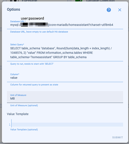

Here’s my working config if it helps:
mysql://user:password@core-mariadb/homeassistant?charset=utf8mb4
SELECT table_schema "database", Round(Sum(data_length + index_length) / 1048576, 2) "value" FROM information_schema.tables WHERE table_schema="homeassistant" GROUP BY table_schema

Right, just to finish this off and thank you all again, the secrets were:
  1. I was wrong about the need to supply mysql url, even if it is set in recorder. Use the same url as you specified in configuration.yaml
  2. My final gotcha was not to put any quotes around the query.
Thanks all. I marked @tom_l as the solution because this one put me on to the lack of need for quoting, but others helped too.
