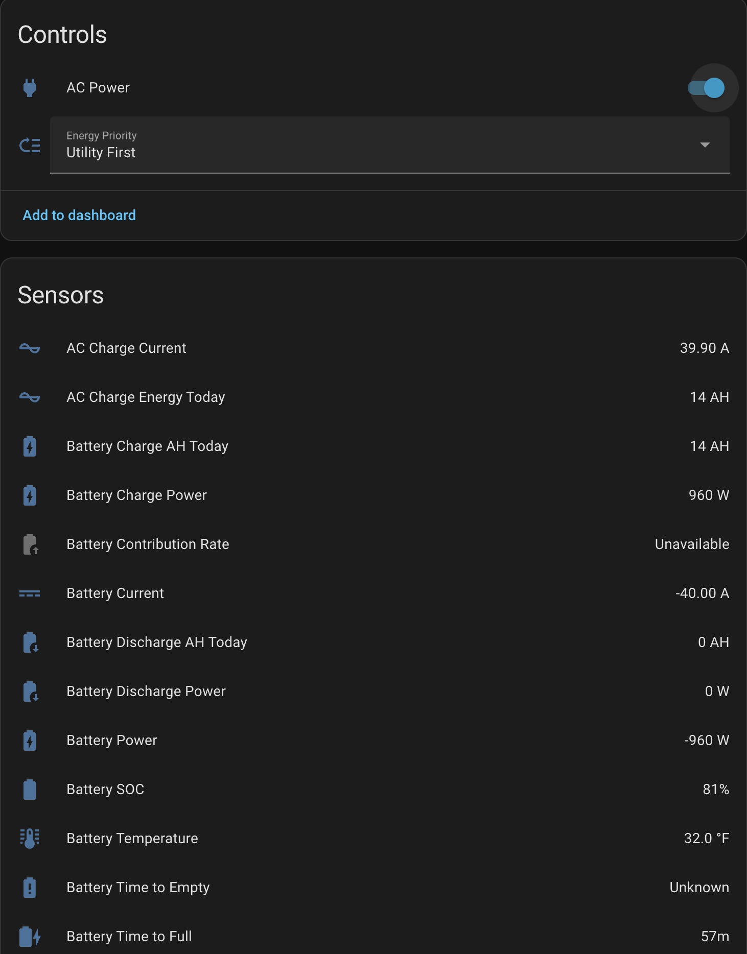

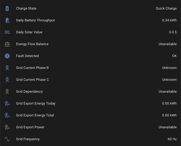

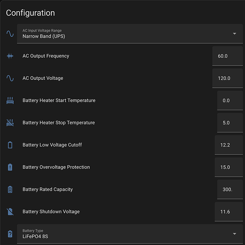

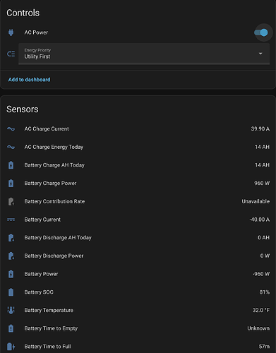

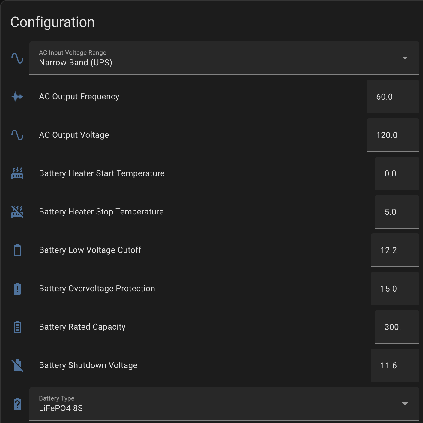

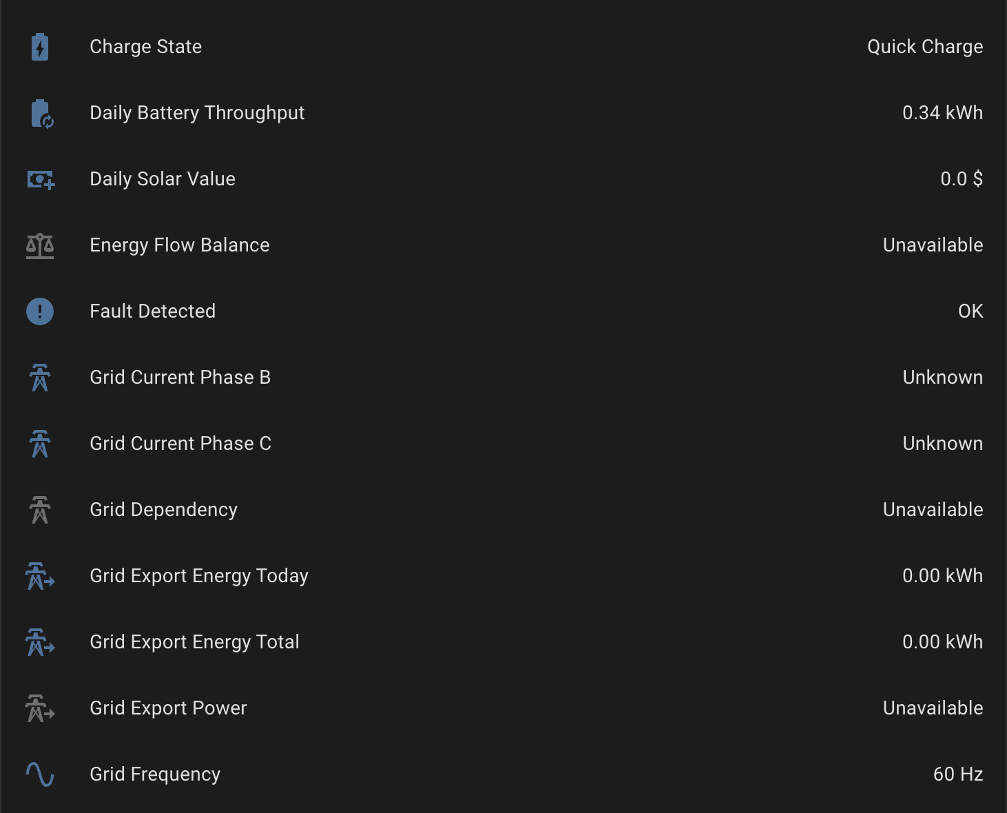

Some screenshots (My implementation shows 151 entities though many are listed as “Unknown” since they rely on features I have disabled or have not used)
