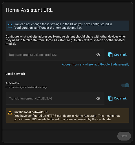

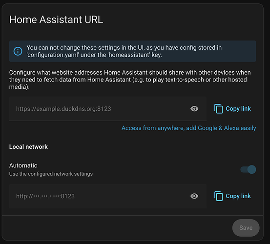

In the UI I can find this:
Screenshot 2024-10-12 at 12.06.39
which says that UI is disabled (so I cannot change “Internet” edit box).
If I switch Local network to manual, it just displays similar box for it, but I cannot change this one too.
Screenshot 2024-10-12 at 12.06.17

I also have the same issue as the original poster. I am able to access the ‘Home Assistant URL’ section but no way to change anything.
Any idea how to fix the issue in the yellow box?
