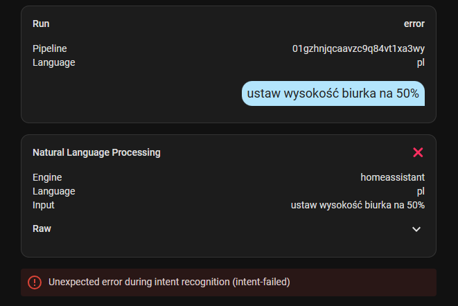

Recently I connected ESP8266 to my desk and configured it by ESP Home. It’s working but next step is to controll it by voice and I’m missing something.
Desk is visible in HA as a cover.

It should parse the percent value and use it in intent script but I get an error:
RAW
stage: error
run:
pipeline: 01gzhnjqcaavzc9q84vt1xa3wy
language: pl
runner_data:
stt_binary_handler_id: null
timeout: 30
events:
- type: run-start
language: pl
runner_data:
timeout: 30
timestamp: "2023-08-15T22:54:13.770294+00:00"
- type: intent-start
engine: homeassistant
language: pl
intent_input: ustaw wysokość biurka na 50%
conversation_id: null
device_id: null
timestamp: "2023-08-15T22:54:13.770373+00:00"
- type: error
code: intent-failed
message: Unexpected error during intent recognition
timestamp: "2023-08-15T22:54:13.920498+00:00"
intent:
language: pl
device_id: null
done: false
error:
code: intent-failed
